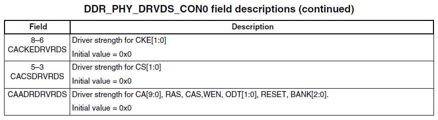

We adjust the drive strengh for the memory address using CAADRDRVRDS in DDR_PHY_DRVDS_CON0 register.
However, the description in i.MX7 reference manual is only CA[9:0].
* Page 2346 in i.MX 7Dual Applications Processor Reference Manual, Rev. 0.1
Which register does the drive strengs for bits higher than CA[9] use?

 bit field CAADRDRVRDS of DDR_PHY_DRVDS_CON0 controls all i.MX7 DRAM address
lines.
