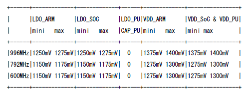

Aemj
Hi Ross,
Thanks a lot for your kindly explanation.
After reading your answers, the customer’s understanding is as below.
Could you tell me whether the understanding is correct?
As for 1;
The voltage value stated in the comment columns for LDO enabled mode is minimum set point. For example, 1.250V is the minimum set point for operation up to 996 MHz.
As for 2;
PU LDO can be set to 0, when no GPU use.
As for 3;
One must follow the following rules.
- ARM_IN and SOC_IN must be at least 125mV greater than their associated _CAP set point.
- VDD_SOC and VDD_PU output voltage must be set to this rule: VDD_ARM - VDD_SOC / VDD_PU < 50mV. (note-4)
As for 4;
The ‘/’ mark does not mean divisor, and it means ‘OR’ so to speak.
As for 5;
The behavior in 600MHz is not tested in NXP’s BSP, then the voltage values for 600MHz are not guaranteed. One should use the setting for 792MHz if more reliability is needed.
In conclusion, the following setting is fine for them.
Does it correct?
Miyamoto
1,661 Views
RossMcLuckie
Hi Miyamoto,
All understandings are correct and the table settings is good.
Ross
