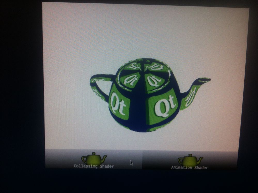

Ater this step you should be able to run demos  using the wayland-egl platform like this:
$ ./forest_qml -platform wayland-egl
Now in order to install Qt3D follow this guide:
https://community.freescale.com/docs/DOC-94236
And
$./shaders -platform wayland-egl
Voila!
