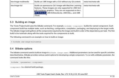

I am using  custom board based on  IMX6UL EVK NXP . I am flashing qt5-image.wic  and i am able to see penguin logo and openembedded logo but i cant able to find the Qt browser and Qt media in the image. Is their Qt support for this image? If not please let me know how to add Qt image...

Hi Shamiullah
for NXP Qt support one can look at Table 1. i.MX Yocto project images
i.MX Yocto Project User’s Guide​

Thanks for your valuable response. I am using fsl-image-qt5-validation-imx image . Does it support QT?
Is any one of the images in the table support qt for IMX6UL?

one can also look at answers from meta-fsl-arm mailing list :
https://www.mail-archive.com/meta-freescale@yoctoproject.org/msg17890.html
Officially (based on Release Notes document) it is not supported, however there are community efforts:
https://community.nxp.com/t5/i-MX-Processors-Knowledge-Base/Enable-QT-developement-for-i-MX6UL/ta-p/...
