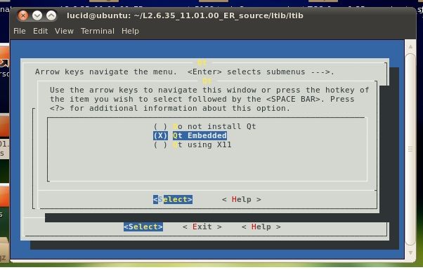

I'm from italy and I have some question:
I have QT Creator and I made an application and runs perfectly on the pc with ubuntu ...
1) how do I cross-compile it for the imx53?
2) What I must activate on LTIB for to create a rootfs with all the necessary libraries?
3) For example if I need the phonon library how do I cross compile the application on my PC and then run it properly sull'imx53? I have tocompile QT libraries for arm? How?
4) How activate the Gstreamer plugin on imx53?
thanks

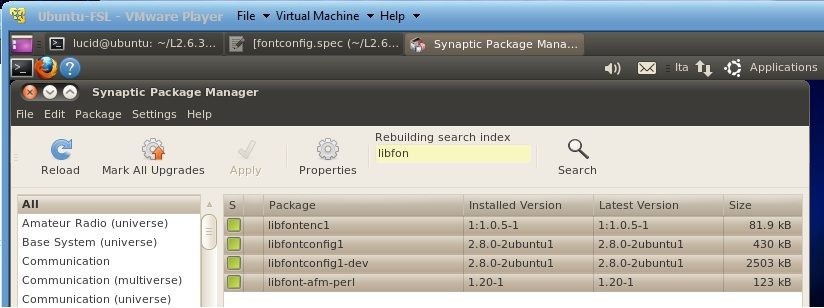

enaud
i've resolved with this code:
my fontconfig.spec modified is:
./configure --prefix=%{_prefix} --host=$CFGHOST --build=%{_build} --with-arch=$GNUTARCH --sysconfdir=%{_sysconfdir} --with-freetype-config="$DEV_IMAGE/usr/bin/freetype-config --prefix=$DEV_IMAGE/usr"
make
Now I have a Rootfs with all library QT? there is Phonon?
Now I can compile my app on Target with qmake?
Thanks and sorry for my stupid answer but i'm a newbie :)

try to install from synaptics, by checking the proper dev files.
6,078 Views
enaud
I have error:
lucid@ubuntu:~/L2.6.35_11.01.00_ER_source/ltib/ltib$ sudo apt-get install libconfig1-dev
Reading package lists... Done
Building dependency tree
Reading state information... Done
E: Couldn't find package libconfig1-dev
6,078 Views
KrishnaPavan
Install, developer files of font config like libconfig1-dev on your host.
6,078 Views
enaud
fontconfig.spec is correct and fontconfig-2.4.2 is available in opt/freescale/pkgs :(
6,078 Views

enaud
Where?
./ltib -c---->Package List---->Qt(Qt Embedded)----> Here I have 3 solution:
