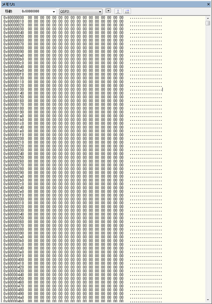

Hello, Community.
Previously, I ’ve asked questions in the following thread,
QSPI flash cannot be accessed if the MCIMX7SABRE board is set to other than QSPI Boot.
QSPI Flash cannot be accessed when booted with other than QSPI Boot
The QuadSPI configuration parameters have been written with the program image using the IAR flash loader.
These should be written at address 0x60000000-, but when booted by other than QSPI Boot, they are all 0 when dumped with IAR EW.
The address 0x60000400-, where the program image should be written, are 0 as well.
Do you know why?
Do I need any Quad SPI settings?
The following implementation has been implemented on the MCIMX7SABRE board.
QSPI signals are muxed with EPDC_D[7:0]
When using QSPI:
de-populate R388-R391, R396-R399
populate R392-R395, R299, R300
I'm using IAR's Flash loader.

yuichi_takeda
Hi, igor,
Thank you for your reply!
First, I asked IAR why it was not possible to access QSPI flash if it was booted using something other than QSPI boot.
As a result, I was suggested to ask NXP how to do it.
So I joined the community.
Do you know why I can't access QSPI flash when booting with something other than QSPI boot?
I guess I need to set something.
Yuichi Takeda

yuichi_takeda
Hi, igor,
The version I am using is EWARM-CD-8323-LMS2.
Certainly, the flash loader does not support i.MX7D7.
However, since it seems to be supported as a debugger, I am wondering if the QSPI flash can be erased or written with a boot other than QSPI boot.
Also, when U-Boot is started with the SD card attached to the MCIMX7SABRE board and the address 0x60000000- is dumped using the "md" command, they are all 0 as well.
Are there any settings required for this?
Yuichi Takeda

yuichi_takeda
Hi, igor,
I'm sorry for the lack of English...
I don't think I should ask IAR about this question.
There are two questions below.
1.
With QSPI boot, I can erase or write the QSPI flash without any problems. However, I can't do it other than QSPI boot.
I'm asking if there are i.MX7 register programming related to QSPI, not IAREW settings.
Is there anything?
2.
When U-Boot is started with the SD card attached to the MCIMX7SABRE board and the address 0x60000000- is dumped using the "md" command, they are all 0.
Do you know why?
At this time, IAREW is not used.
Yuichi Takeda

igorpadykov
Hi Yuichi
suggest to check documentation included in FreeRTOS_BSP_1.0.1_iMX7D
how to program qspi (not use IAREW ) and using jtag check necessary registers
Windows Installer: i.MX 7Dual/Solo FreeRTOS BSP for Cortex-M4
