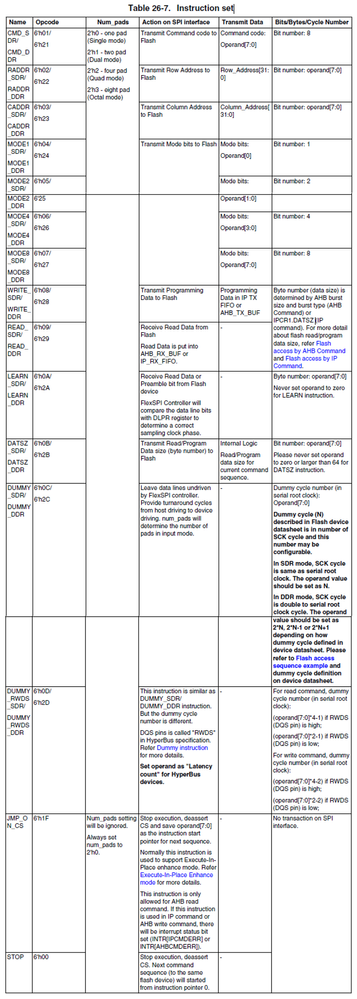

yamakatb
Hi li shaolong,
I reviewed the LUT registration with reference to the QSPI flash data sheet and the attached table.

1245366615
Thank you for your reply. I am very helpful.And I have solved the problem.
