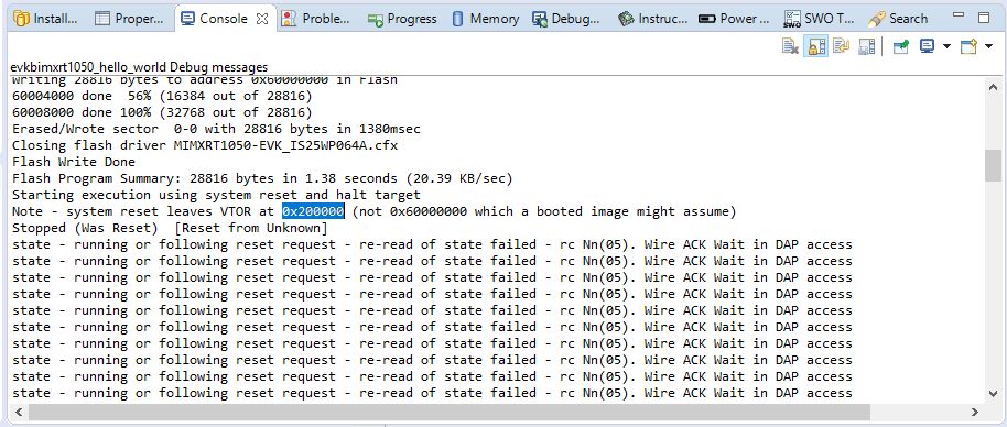

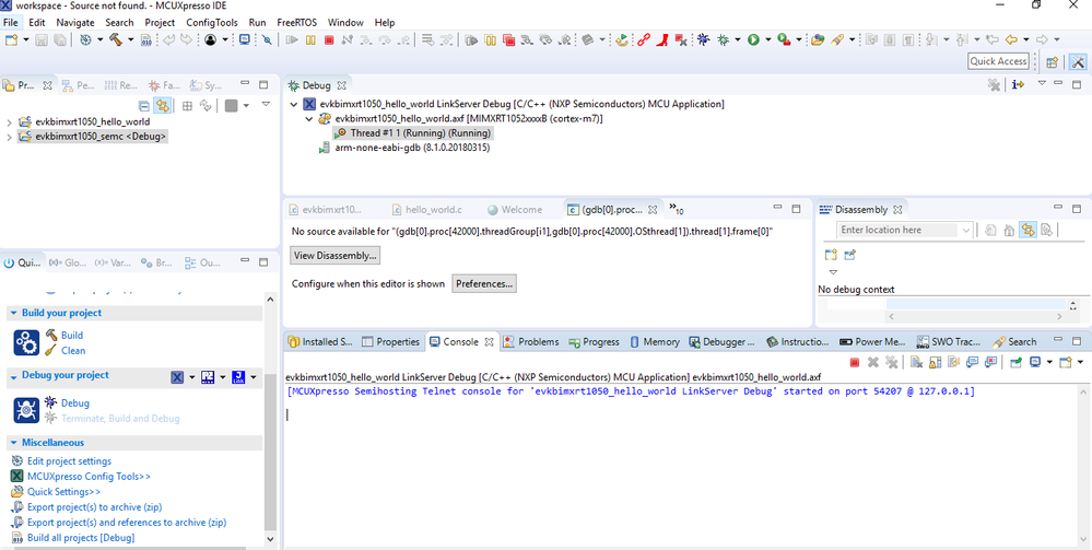

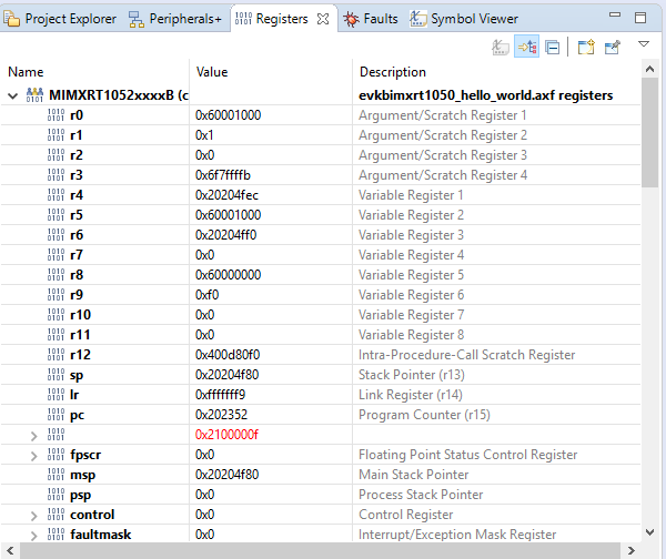

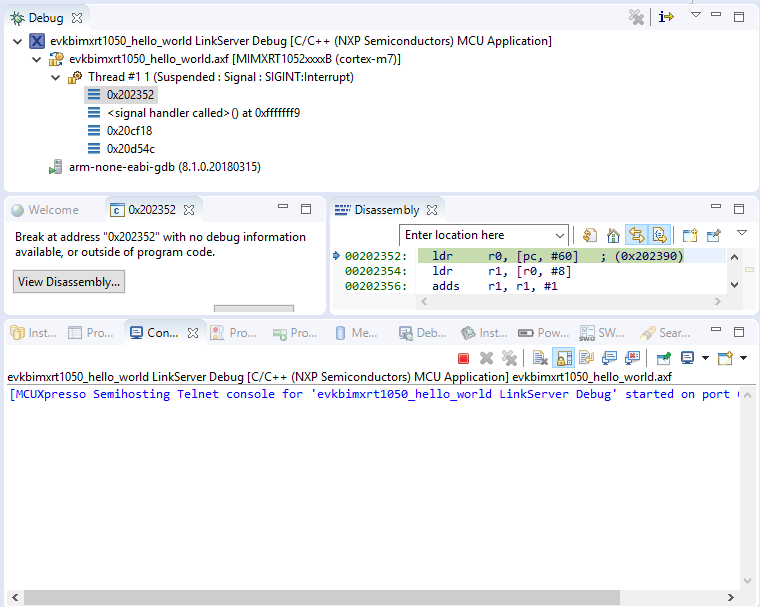

Dear,
I'm working on a project with the NXP i.MXRT1050 family MIMXRT1052DVL6B processor. For preliminary testing I'm using the MIMXRT1050-EVK development kit. For the initial tests we are using the SDX provided by NXP. The Kit has 3 types of flash memory (Hyperflash, QSPI and SD card), the default boot being done by Hyperflash, just as the SDK examples are also configured to work with Hyperflash memory. In the kit Hyperflash memory shares pins with QSPI memory and these cannot be used simultaneously.
As my goal is to use QSPI memory, I removed Hyperflah memory from the kit, and used the hello_word (from SDK) example to work with QSPI memory, and I encounter driver error (image below).

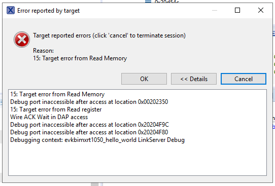

Following I set up the same project (hello_word_ as images below and was able to write it in the kit, enter debug mode, but MCUXpresso can not execute the lines of code.
After using these settings, the errors below occurs.
I ask for help in understanding and solving this problem.
From now, my sincere thanks.
Rubens Júnior.

Hi Rubens Junior,
You totally don't need to remove the on board hyper flash, you just need to modify the resistor to make the qspi work.
Now please follow my way to do it again, I already make it work on both the MCUxpresso IDE and the IAR.
Please still use the board which already modify the on board resistor: USE QSPI FLASH(Mount R153~R158, DNP R356,R361~R366)
1. Change the on board opensda firmware to DAPLink v0244 - Supports onboard spi-flash
  1)download k20dx_mimxrt1050_evk_qspi_if_crc_20180419.zip from this link:
     https://www.nxp.com/assets/downloads/data/en/initialization-boot-device-driver-code-generation/k20dx...
    unzip it, you will get this .bin file:k20dx_mimxrt1050_evk_qspi_if_crc.bin
  2) power off the board by unplug the usb cable
  3) press the SW4 button and hold on it, then plug the usb cable, you can find a device named as "MAINTENANCE".
     Then release the SW4 button.
  4) send k20dx_mimxrt1050_evk_qspi_if_crc.bin to "MAINTENANCE", and want the sending finished.
  5) power off the board, then plug the usb cable to J28 again, wait a moment, you will find a device named as "RT150-EVK"
  until now, the on board debugger is changed the qspi compatible firmware, you can use the CMSIS DAP to debug the code now.
2. Modify the code, let's take the iled_blinky as an example
  1) import iled_blinky code to MCUXpresso IDE, you can find this project in folder:
   SDK_2.5.0_EVKB-IMXRT1050\boards\evkbimxrt1050\demo_apps\led_blinky
  2) change the flash Driver to :MIMXRT1050-EVK_IS25WP064A.cfx
  3) Modify this code, this is the most important part, which I forget to tell you in the last email
    Open evkbimxrt1050_flexspi_nor_config.c in project folder xip.
    Please comment these code:
const flexspi_nor_config_t hyperflash_config = {
    .memConfig =
            .tag = FLEXSPI_CFG_BLK_TAG,
            .version = FLEXSPI_CFG_BLK_VERSION,
            .readSampleClkSrc = kFlexSPIReadSampleClk_ExternalInputFromDqsPad,
            .csHoldTime = 3u,
            .csSetupTime = 3u,
            .columnAddressWidth = 3u,
            // Enable DDR mode, Wordaddassable, Safe configuration, Differential clock
            .controllerMiscOption =
                (1u << kFlexSpiMiscOffset_DdrModeEnable) | (1u << kFlexSpiMiscOffset_WordAddressableEnable) |
                (1u << kFlexSpiMiscOffset_SafeConfigFreqEnable) | (1u << kFlexSpiMiscOffset_DiffClkEnable),
            .sflashPadType = kSerialFlash_8Pads,
            .serialClkFreq = kFlexSpiSerialClk_133MHz,
            .sflashA1Size = 64u * 1024u * 1024u,
            .dataValidTime = {16u, 16u},
            .lookupTable =
                    // Read LUTs
                    FLEXSPI_LUT_SEQ(CMD_DDR, FLEXSPI_8PAD, 0xA0, RADDR_DDR, FLEXSPI_8PAD, 0x18),
                    FLEXSPI_LUT_SEQ(CADDR_DDR, FLEXSPI_8PAD, 0x10, DUMMY_DDR, FLEXSPI_8PAD, 0x06),
                    FLEXSPI_LUT_SEQ(READ_DDR, FLEXSPI_8PAD, 0x04, STOP, FLEXSPI_1PAD, 0x0),
    .pageSize = 512u,
    .sectorSize = 256u * 1024u,
    .blockSize = 256u * 1024u,
    .isUniformBlockSize = true,
Then add these code:
const flexspi_nor_config_t qspiflash_config = {
    .memConfig =
            .readSampleClkSrc = kFlexSPIReadSampleClk_LoopbackFromDqsPad,
            .csHoldTime = 3u,
            .csSetupTime = 3u,
            .sflashPadType = kSerialFlash_4Pads,
            .serialClkFreq = kFlexSpiSerialClk_100MHz,
            .sflashA1Size = 8u * 1024u * 1024u,
            .lookupTable =
                    // Read LUTs
                    FLEXSPI_LUT_SEQ(CMD_SDR, FLEXSPI_1PAD, 0xEB, RADDR_SDR, FLEXSPI_4PAD, 0x18),
                    FLEXSPI_LUT_SEQ(DUMMY_SDR, FLEXSPI_4PAD, 0x06, READ_SDR, FLEXSPI_4PAD, 0x04),
    .pageSize = 256u,
    .sectorSize = 4u * 1024u,
    .isUniformBlockSize = false,
  4)Save the code, and build the project.
3. Download the code to the RT1050 board.
  You can refer to these application note:
https://www.nxp.com/docs/en/nxp/application-notes/AN12183.pdf
https://www.nxp.com/docs/en/application-note/AN12108.pdf
Configure SW7:1 OFF, 2 OFF, 3 ON, 4 OFF
Then download the code again, it should works OK.
Wish it helps you!

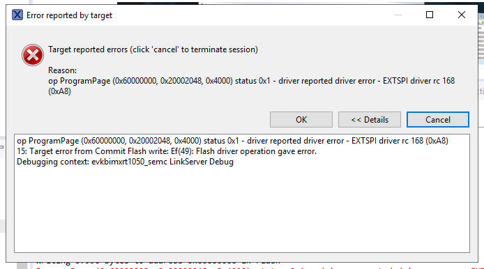

mukelarvin
This might be a red herring, but I followed kerryzhou‌ and [email protected]‌'s advice and it still didn't work for me.
Then I tried the MIMXRT1050_SFDP_QSPI.cfx driver instead of the MIMXRT1050-EVK_IS25WP064A.cfx driver and that worked. However now I've switched back to the MIMXRT1050-EVK_IS25WP064A.cfx driver and my code still works... Does anyone know why that may have helped? Could the memory have gotten into some sort of unstable state and the more generic driver made it recover?

   When you meet the can't download problems, you also can try to do the external chip mass erase at first, then you download it again should works.

amwilhite
For others who may experience the 0xA8 error, it appears that the root cause of the error for me was inadequate power. After connecting a 5VDC adapter to the board and switching the J1 jumper to pins 1 and 2, I was able to successfully program and line step with both the on-board CMISIS-DAP probe (after re-programming it with the Quad-SPI-compatible firmware) and an external J-Link (after editing the JLinkDevices.xml file).
