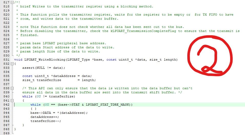

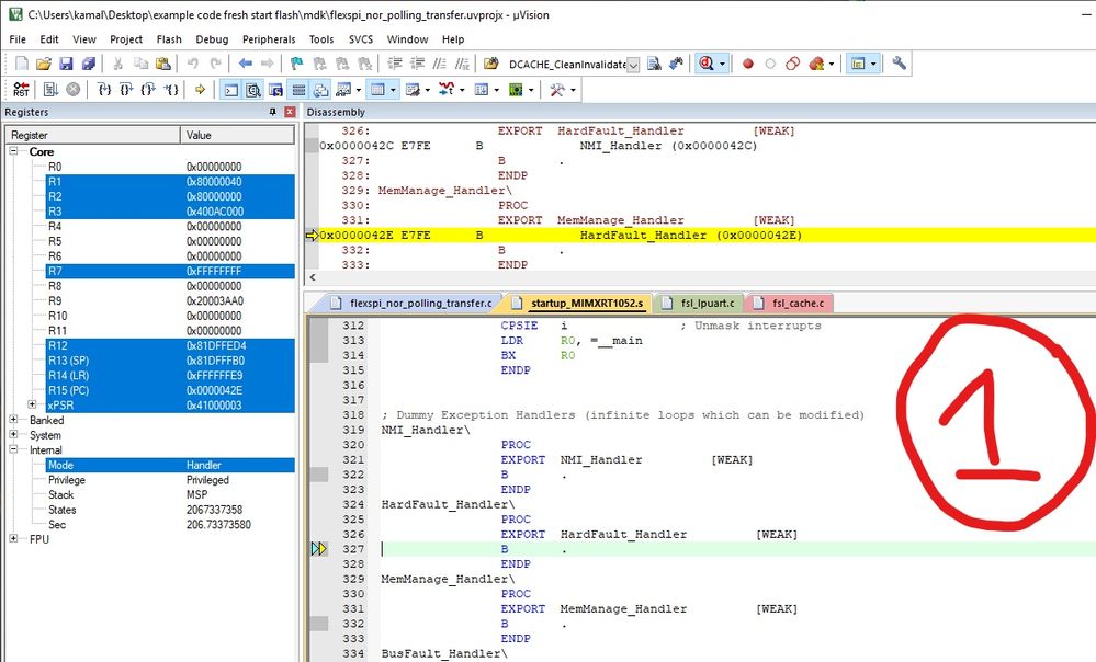

Thanks for answering my questions. I am currently testing programming and erasing the flash using one of the given Keilv5 example projects: "flexspi_nor_polling_transfer". I can program to flash as expected but when I try to erase the flash in the location I programed already, I get errors.
Erasing the entire flash over flexspi is working fine, but the status of the sector erase function returns "failed" and looking at the flash through the memory window shows the incorrect values such as "0x00" or "0xFE" instead of the correct value of "0xFF". Also the program will hang after failing the erase function and I get stuck in a hard fault. Shown in image 1.
Other debugging runs also hang while trying to print something through the uart. The while loop the program is hanging in is in the "LPUART_WriteBlocking" function. Shown in image 2.
Any idea why programming the flash is working but erasing is not?
Why am I getting stuck in the "LPUART_WriteBlocking" function at random times?
Kamal
