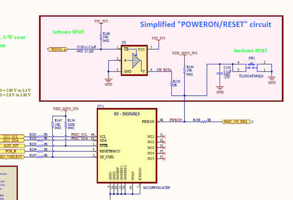

Reset circuitry in IMX6UL reference design query:

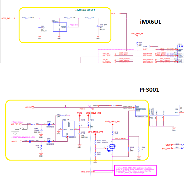

The below shows the NXP reference design reset circuits. NXP ref design used two different reset circuits for i.MX6UL & PMIC.
1.Why do we require two different reset circuit? Could you please explain?
2.We followed simple reset circuit to PMIC power on pin as shown figure below, this circuit was taken from our existing i.MX6 Solo design which was already working, we hope it will work same for PMIC PF3001 part as well. Am i right?
3.  Is there any silicon version issue for new version (i.MX6UL)?
Thanks in advance

igorpadykov
Hi Ramesh
1. please refer to
https://community.nxp.com/message/862062?commentID=862062#comment-862062
2. I think it should work fine with PMIC PF3001 as well
3. no
igor
