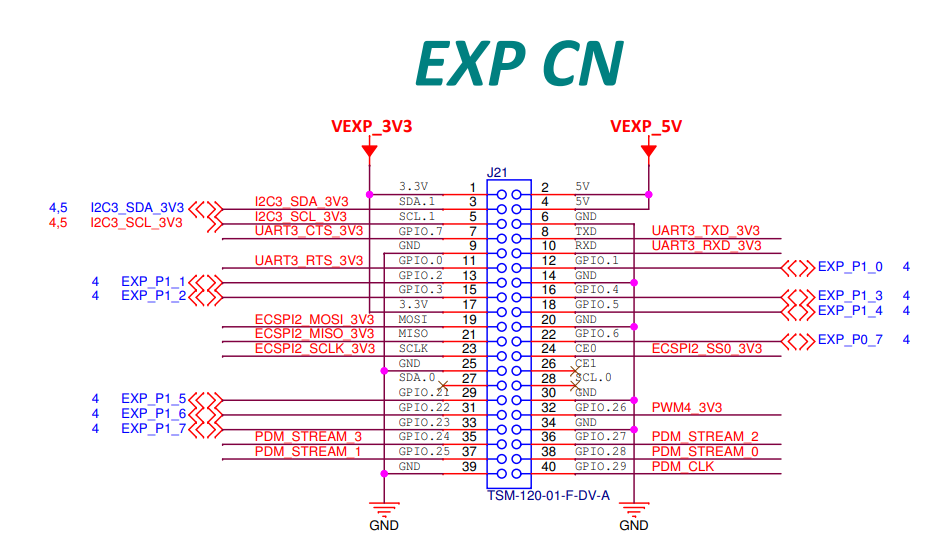

I am Nitin B S who is also trying to enable PWM in imx8m plus evk through sysfs. I am activating my pwmchip and pwmchannel and running the code. The code is being executing as expected but when i connect the LED to board the results are not being reflected in my LED it is not even turning on.
I am connecting my LED as shown in the config below to pin number 32(PWM4).
Can you please help me regarding the issue.
Thanks and Regards
Nitin B S
