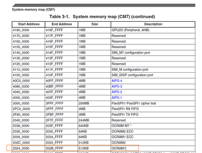

I'm using i.MXRT1170-evkb board. I am trying to run the NXP provided Flash-loader SDK example code for CM7 core. I couldn't find any Readme.md file. So if I want to analyze the code provided in the example I'm facing difficulty to understand for what purpose this example has been provided.
And I want to know which Flash memory is being used in the same example. I have attached the MEMORY section in linker script, there I couldn't understand which memory section is being used.
Please help me regarding this.

When you import this SDK demo, it will show some introduction  about this demo.  The  flashloader is a bootloader that executes from target RAM memory on the platform.
what you upload memory picture address  is OCRAM address.
