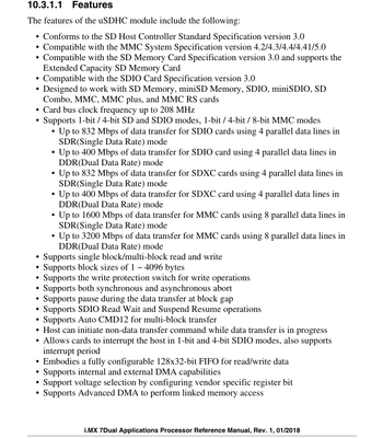

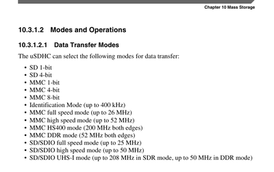

It means, that i.MX7 does not support SDXC cards at all, or only this specific one?
Looking to reference manual it should support SDXC and UHS-I.
Michal
