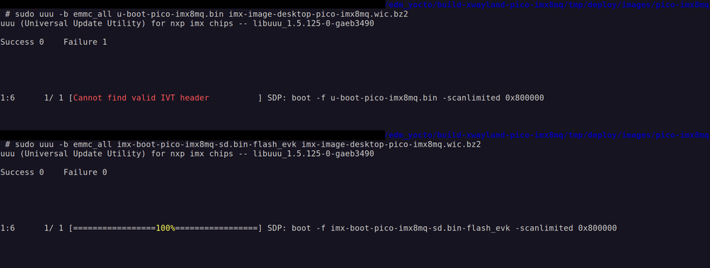

I'm having a problem flashing an ubuntu image (https://github.com/TechNexion/tn-imx-yocto-manifest) on a PICO-PI-IMX8M (exactly an iMx8MQ).
The command "$:bitbake imx-image-desktop" went all the way.
So I move to the “edm_yocto/build-xwayland-pico-imx8mq/tmp/deploy/images/pico-imx8mq” folder as indicated by the doc (https://developer.technexion.com/docs/using-uuu-to-flash-emmc) looking for the correct ".bin" to launch the command "$: sudo uuu -b emmc_all [***.bin] imx-image-desktop-pico-imx8mq.wic".
I installed uuu following this guide (https://emteria.com/kb/uuu-linux), because I had a problem with tinyxml following the installation indicated by TNX (https://github.com/TechNexion/imx-mfgtools-tn).
I first tested with "u-boot-pico-imx8mq.bin", it gave me this error. I tried with other files, same thing.
$: sudo uuu -b emmc_all u-boot-pico-imx8mq.bin imx-image-desktop-pico-imx8mq.wic.bz2/*
I then looked for other files to test, this one allowed me to go further ("imx-boot-pico-imx8mq-sd.bin-flash_evk"), but it blocks indefinitely at this step.
$: sudo uuu -b emmc_all imx-boot-pico-imx8mq-sd.bin-flash_evk imx-image-desktop-pico-imx8mq.wic.bz2/*
I can't find any help online so I'm posting here.
Thank you in advance for any help you can give me, it is very important to me.

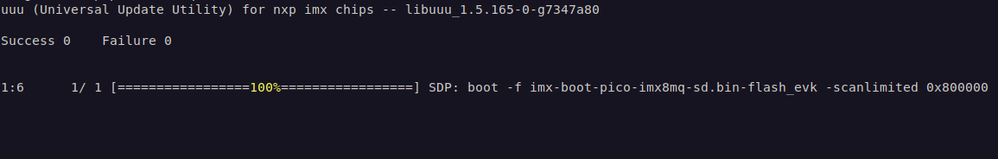

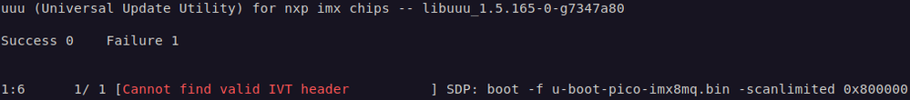

Hpot
Thank you for your reply.
I just applied your advice (change the version of uuu and reinstall it with mfgtools) but unfortunately without success. (see screen).
Could it be that my bootloader (u-boot-pico-imx8mq.bin) is corrupted or something like that, leading to the "Cannot find valid IVT header" error.
