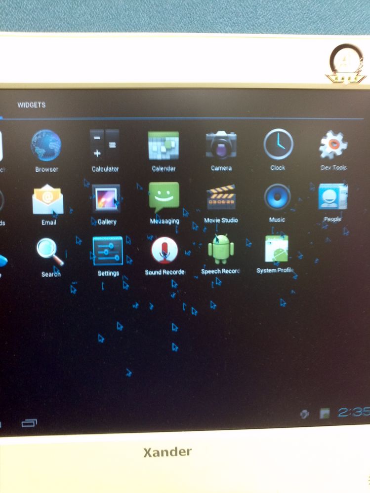

BUT when we boot into Android V13.4 BSP, Android boots up OK and correctly "sees" the 2GB of DDR3 memory BUT when one moves out of the Android lock screen into any other screen (eg: any settings screen) the ouse pointer leaves trailing pounters all over the show which never get erased. When we set memory size back to 1GB settings everythig works great. I have seem 1 other report from someone in China with the same problem and same configuratuon, so we are not alone. Have a look at: any one use 2GB ddr3 with imx6q android bsp? (he also attaches a great screenshot of this "trailing mouse pointer" problem - which is 100% the same as as we are seeing). Same problem occurs on both dual and quad i.MX6.

Summary the conclusion:
1. Confirmed the trailing mouse issue not exist if disable android swap rectangle feature.
2. GPU reserved memory address region should be limited within 2G as GPU command buffer use reserved memory and it can’t accept virtual memory. Our kernel code has this limit memblock_alloc_base(imx6q_gpu_pdata.reserved_mem_size,SZ_4K,SZ_2G) for 2G DDR device for example FSL SabreAI reference board.
3. fb0base address can be set to > 2G, but there will be some performance drop, so suggest customer not set fb0base > 2G.
5,333 Views

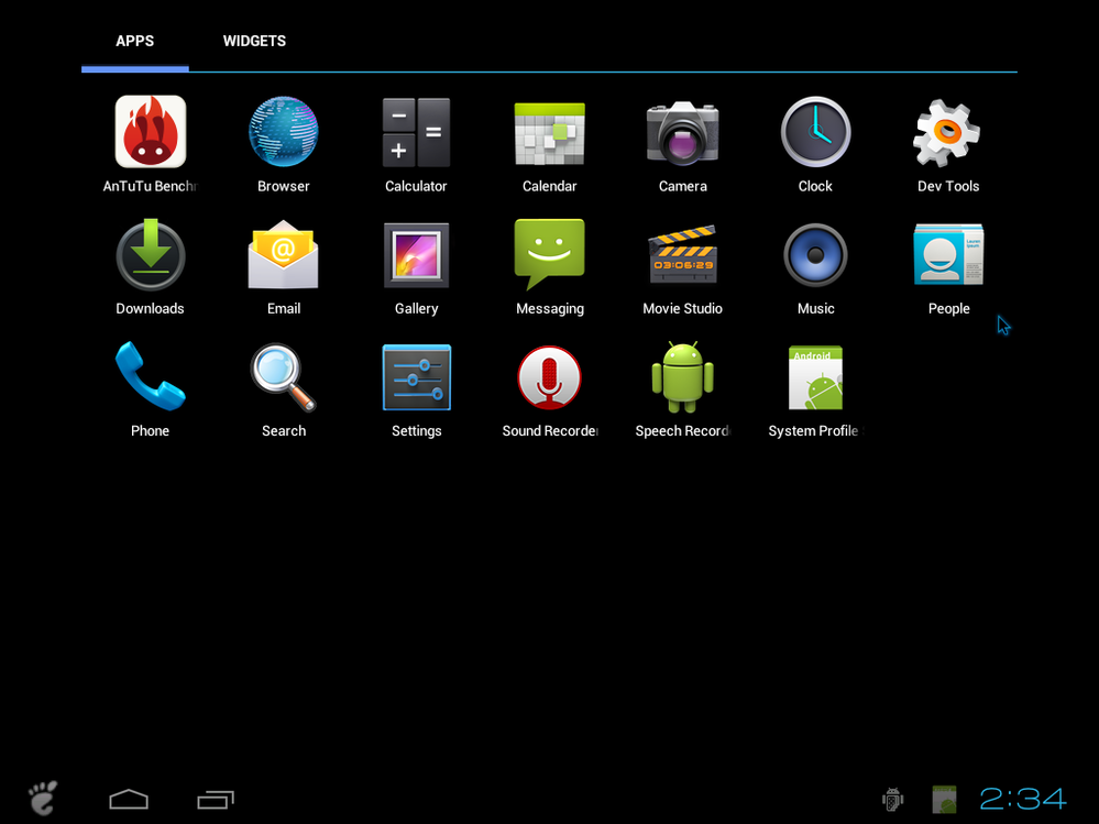

MaxChou
Hi  All
screenshot from ddms, there is no "trailing mouse pointer"
photo from my phone,you could see the  "trailing mouse pointer"
does any one could give me some idea about this ?
Sincerely,Max
