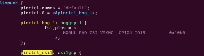

I'm having problems configuring the GPIO on my imx6ul-evk... I've built L5.4.3 as follows:
$ repo init -u https://source.codeaurora.org/external/imx/imx-manifest -b imx-linux-zeus -m imx-5.4.3-1.0.0.xml
$ repo sync
$ DISTRO=fsl-imx-fb MACHINE=imx6ulevk source imx-setup-release.sh -b build-fb
//Added imx-test utilities to local.conf
$ bitbake core-image-base
I uploaded the core-image-base-imx6ulevk.wic.bz2 image on to the sdcard and booted the imx6ul-evk.  At the u-boot prompt I did:
=>setenv fdt_file imx6ul-14x14-evk.dtb
=>saveenv
and rebooted.
I'm using the imx6ul-14x14-evk.dtb that is the default for L5.4.3.1.
The problem is that when I try to configure GPIO using sysfs, with
$ echo 115 > /sys/class/gpio/export
the GPIO port is not listed in $ ls /sys/class/gpio afterwards.
I'm having the same problem as in Simple GPIO Example - quandry  and usedBiyongSUN's example using memtool to check the IOMUX:
One important thing, you need to check the IOMUX you configured is correct for GPIO.
root@imx6qdlsolo:~# echo 115 > /sys/class/gpio/export
root@imx6qdlsolo:~# /unit_tests/memtool 0x20a8004 1
E
Reading 0x1 count starting at address 0x020A8004
0x020A8004:  0E050000
However the result I get is
root@imx6ulevk:/unit_tests# ./memtool 0x20a8004 1
E
0x020A8004: 00800400
I'm a bit new to linux on embedded systems ... where should I start to debug this?

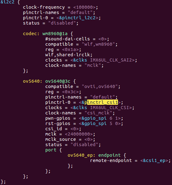

Are you trying to export or access GPIO4_IO19, right?
If so, then this pin has been configured as a "CSI_VSYNC" in CSI module of imx6ul EVK.
So, to use this pin as a GPIO, you need to first disable the node in which this pin-muxing is used and after that you need to configure this pin as a gpio in device tree.
This "CSI_VSYNC" pin-muxing has been defined in the i2c2 node in "imx6ul-14x14-evk.dtsi" device tree file. So I have disabled this node in device tree and configure this pin-muxing as GPIO as shown in below screenshots.
Screenshot from 2020-05-12 16-52-19.png      Screenshot from 2020-05-12 16-52-44.png
By doing the above configurations, I am able to export the GPIO pin 115 on the board.
Hope this will help you.
Let us know if you have any query regarding this.

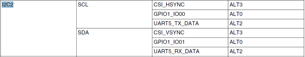

Thank you shivanipatel and weidong.sun; but what is the logic to know GPIO4_IO19 is mapped to i2c2?
3,822件の閲覧回数
weidong_sun
Hi Jay,
   GPIO4_19 can't be mapped to I2C2, About signals' mapping , you can get all infromation from i.MX6UL Rreference manual.
this means I2C2_SCL can be routed to one of 3 pads: CSI_HSYNC or GPIO1_IO00 or UART5_TX_DATA, and I2C2_SDA also has 3 options.
