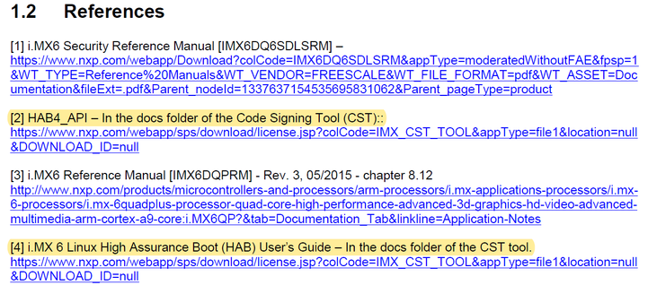

C300 have a Preloader folder. If I refer AN4581 I am not able to find any information regarding Preloader.
Q1. Is it custom implementation?
Q2. How can I get some information about bootflow?
Thank you

Hello @shantanu-banerjee,
[Richard] Preloader is a part of fail-safe boot solution that was provided by MSS team as a commercial service. You can get additional information if you ask LGE to share "failsafe_user_guide.pdf" document.
Q2. How can I get some information about boot-flow?
[Richard] I remember the boot-flow is included in release note of MSS solution. But you need to ask LGE to share it. Following is brief of the flow.
Thank you.

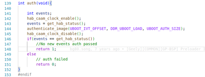

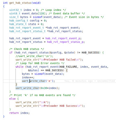

Hello Support Team,
I have a question related to preloader.
As I have understood Preloader is responsible to authenticate Uboot.But problem is that I am not able to print HAB authentication log from Preloader. It seems Preloader not including standard C functions.
My question is how to print HAB events from Preloader? Because I am getting HAB authentication failed but unable to understand the reason.
Below is the code snippet from Preloader source.
Thank you for your support.

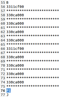

shantanu-banerjee
Dear Support Team,
We have successfully printed HAB log from Preloader.
As we have understood error as below. But we are unable to identify the exact reason for this failure.
It will be helpful if you share some information opinion on this.
HAB Event 1 = 3311cf00 = HAB_INV_CSF
HAB Event 2 = 330ca000 = HAB_INV_ASSERTION
HAB Event 3 = 330ca000 = HAB_INV_ASSERTION
HAB Event 4 = 330ca000 = HAB_INV_ASSERTION
HAB Event 5 = 330ca000 = HAB_INV_ASSERTION
Please find below details

Then use below function for authentication in main.c (Preloader)
authenticate_image(UBOOT_IVT_OFFSET, DDR_UBOOT_LOAD, UBOOT_AUTH_SIZE);
habApiIf.c
hab_rvt_authenticate_image(1, ivt_offset, (void **)&start,(size_t *)&bytes, NULL);

shantanu-banerjee
Dear @Richard_Kim,
Thank you for the reply.

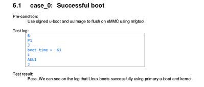

We just want to understand why "invalid CSF" error comes. We are using CSF as described in the fastboot document.
As per the hab_status_t(* hab_rvt::report_status) it is reporting HAB authentication failure but as per failsafe logic it pass the authentication. We need to understand this situation.
Code snippet:
Current log
NXP fast boot test log as per fastboot document
Both log contains B, P1 and J. But as per HAB event log it saying authentication failed.
