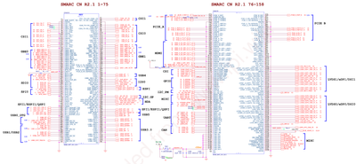

I'm working on development of a new board that will host IMXMP SOC.
I would like someway to poweroff usb port or usb devices from a program in linux userland.
Can i do this with the IMX processor ? does PMIC (regulator chip)  can manage that ?
thks
5 返答(返信)
1,803件の閲覧回数
gnulux
Mainly Host port.
On my final board ( which will have a little power rescue) i will have on USB port :
    - a NFC reader
    - backlight for touchscreen
    - BLE
    - Camera .
At the end, i would like to poweroff all usb port when main power supply is off except for the backlight.
I plan to use a SMARC 2.1 card with a IMX8MP this card has 6 USB ports + 1 OTG available.
I was wondering if if it was possible ?

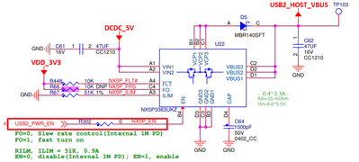

For HOST port, you can control USB2_PWR_EN to close USB2_HOST_VBUS if you reserve this part from EVK.

Zhiming_Liu
Can you share which usb port you need manage power, HOST port  or TYPEC port?
