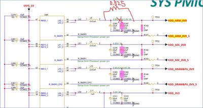

Can you please let us know how to set up the power measurement on i.MX 8MM EVB Kit?
Please indicate where to add 0.025 series resistor on EVB Kit.

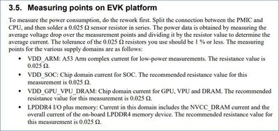

Hi @Jack-Cha,
If one wants to measure power for the VDD_ARM_0V9 power rail, one needs to remove the R141 0R resistor and populate the 0.025R (with a tolerance of 1% or less) resistor. The power value is obtained by measuring the average voltage drop over the measurement points and dividing it by the resistor value to determine the average current.
