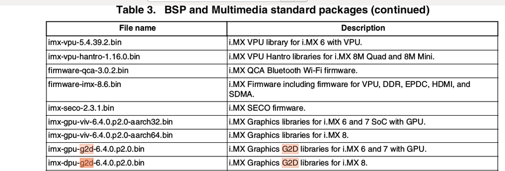

As we plan to port in-house kernel to i.MX7ULP to support 2D only applications, we would like to port G2D infrastructure.
Section 2.4 "Support of new operating system in G2D" of document "i.MX Graphics User's Guide" (ref. IMXGRAPHICUG Rev.2) tells about [G2D repository copy].
How can we retrieve this repository ?
Are there extra dependencies to be retrieved as well ?

Hi  ko-hey,
Yes, it is the same for i.MX7ULP you can refer to Table 3. BSP and Multimedia standard packages from attached i.MX Linux® Release Notes, Rev. L5.4.3_1.0.0, 03/2020.
You can also check ./meta-freescale/recipes-graphics/imx-gpu-g2d/imx-gpu-g2d_6.2.4.p4.0.bb file (GPU G2D library and apps for i.MX with 2D GPU and no DPU : i.MX Graphics G2D libraries are supported for both i.MX 6 and 7 with GPU).

Hi Radhika Somaiya,
Is it same as for i.MX7ULP ?
if yes, it's helpful for us.
Ko-hey

Hi ko-hey,
Can you please provide us the detailed information like yocto version which you are using?
You can refer the below link
About G2D API in i.MX6DQ.
I hope it can help you.

Hi Radhika Somaiya
We're using L5.4.3_1.0.0.
