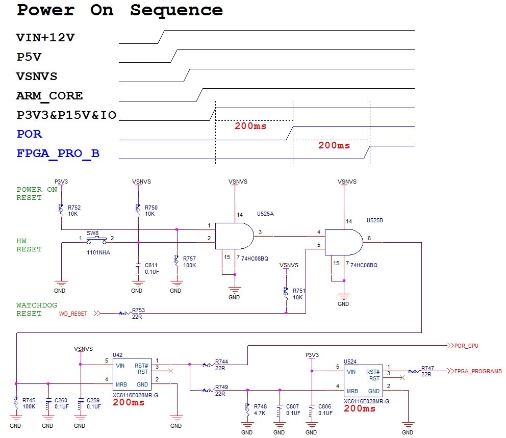

My board will be designed as follows.
The board has not a PMIC.
Please check power sequence & POR signal.
I have one more question.
If I command the "reboot" in linux, does WD_RESET(GPIO_1[ALT1 WDOG2_B]) fall and rise?
Thanks.

Q. Please check power sequence & POR signal.
A. The power-up sequence, shown on your image, seems to be appropriate. The part of the schematic, shown there, has no sense for me.
Q. If I command the "reboot" in linux, does WD_RESET(GPIO_1[ALT1 WDOG2_B]) fall and rise?
A. No.
