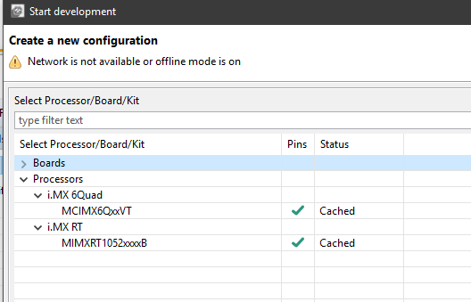

Since v6 there is a different behaviour with the update process compared to v5. v6 cant be used within our network as a because of the tool changes along with our companny restrictions. v5 worked well.
In v6 and windows 7 before using the tool with no admin permissions, the tool has to be updated ones with admin permissions, than the cached data can be used to open/save new cpu-profiles.
In v6 and windows 10 iam not able to start a new design because no CPU-profile can be loaded.

That sounds like a workarround for me. To clarify, i see an issue in v6 handling internet connection based on proxy. Maybe proxy seetings are not used correctly in v6.
I wish someone can look into v6 and fix it.

A similar issue has been encountered previously and in order to fix it a change it <install-dir>/bin/tools.ini is needed, from:
-Dcom.nxp.restapi.server=https://mcuxpresso.nxp.com
To:
-Dcom.nxp.restapi.server=http://mcuxpresso.nxp.com
If this does not solve the issue, would you please share the logs from C:\Users\<username>\.nxp\swtools.log?

Yes this works. I tested with the new version v7.
Will this be implemented in a new version so we dont need to change this manually?
