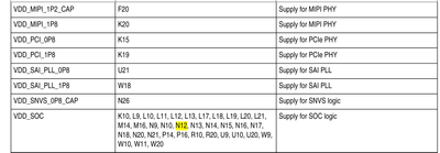

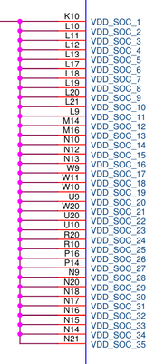

I’ve noticed some discrepancies between the pin naming/assignment in the datasheet for the MIMX8ML8DVNLZAB processor and the schematic of the 8MPLUSLPD4-CPU evaluation board. Specifically, certain power pins (like VDD_SOC_17) are assigned to different locations.
  • The pinout in the datasheet matches exactly with my own PCB design.
  • However, in the 8MPLUSLPD4-CPU eval board schematic, some power pins (e.g., VDD_SOC_17) seem to be assigned to different pins compared to the datasheet.
What could be the reason for this difference?
  • Is it due to a different package type being used?
  • Is there a special revision or variant of the processor for the eval board?
  • Or is this a documentation error?
If anyone has experienced this or can provide clarification, I’d appreciate your help.
Thank you!

Here I think there is a little confusion on your side, please note that all 35 VDD_SOC pads are tied together on the EVK, so in your design it should be the same, no matter the pad number on the schematic since all are VDD_SOC.
