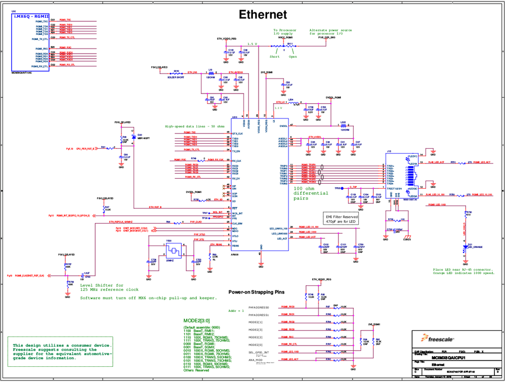

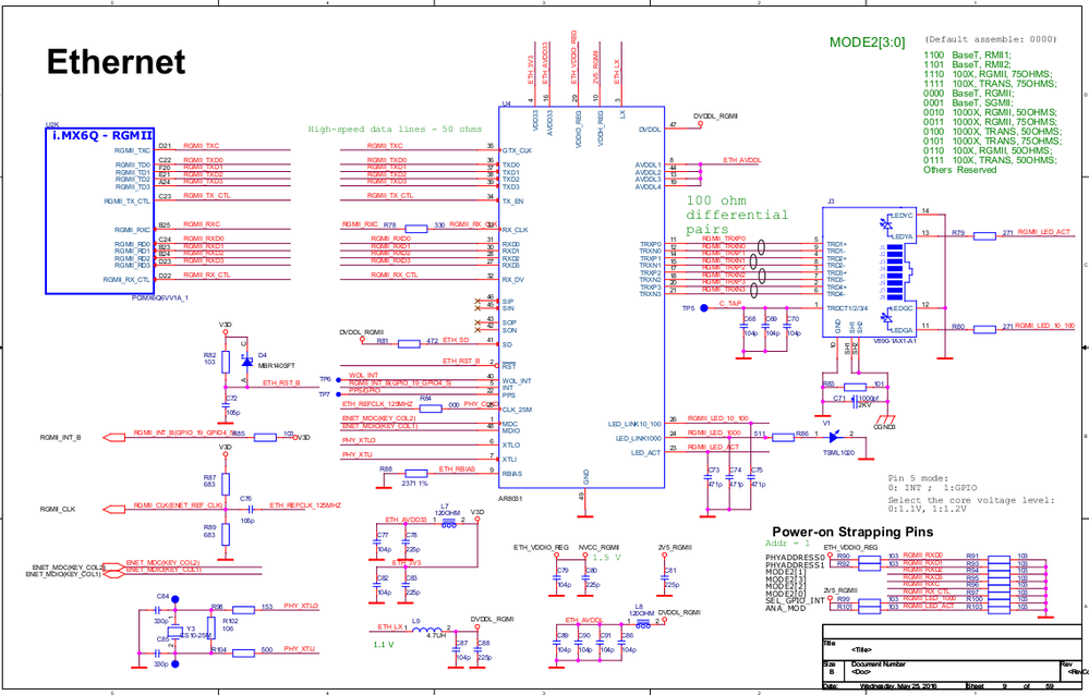

Hallo all :
my board in enet(pg1) is the same of mx6qsabresd-AI(pg2) ,so I use the same code in my uboot of enet ,but it is error:
                                                                            pg1
                                                                  pg2

igorpadykov
one can check if AR8031 is reset properly by ETH_RST_B
~igor

igorpadykov
Hi xuhui
on mx6qsabresd-AI PHYADDRESS0,1=10, while on your schematic both 0.
In general one can also check definitions in include/configs/boardfile.h :
"#define CONFIG_FEC_MXC_PHYADDR"
and add debug codes to ../drivers/net/fec_mxc.c
igor
