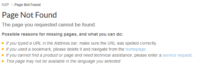

guohu
Hi Igor,
Thank you!
But when I selected Professional Engineer Services, clicked the Request a quote for Services, then submitted the contents.
The web jumped to "Page Not Found" page as following:
Do you have any idea about it?
Guohu
