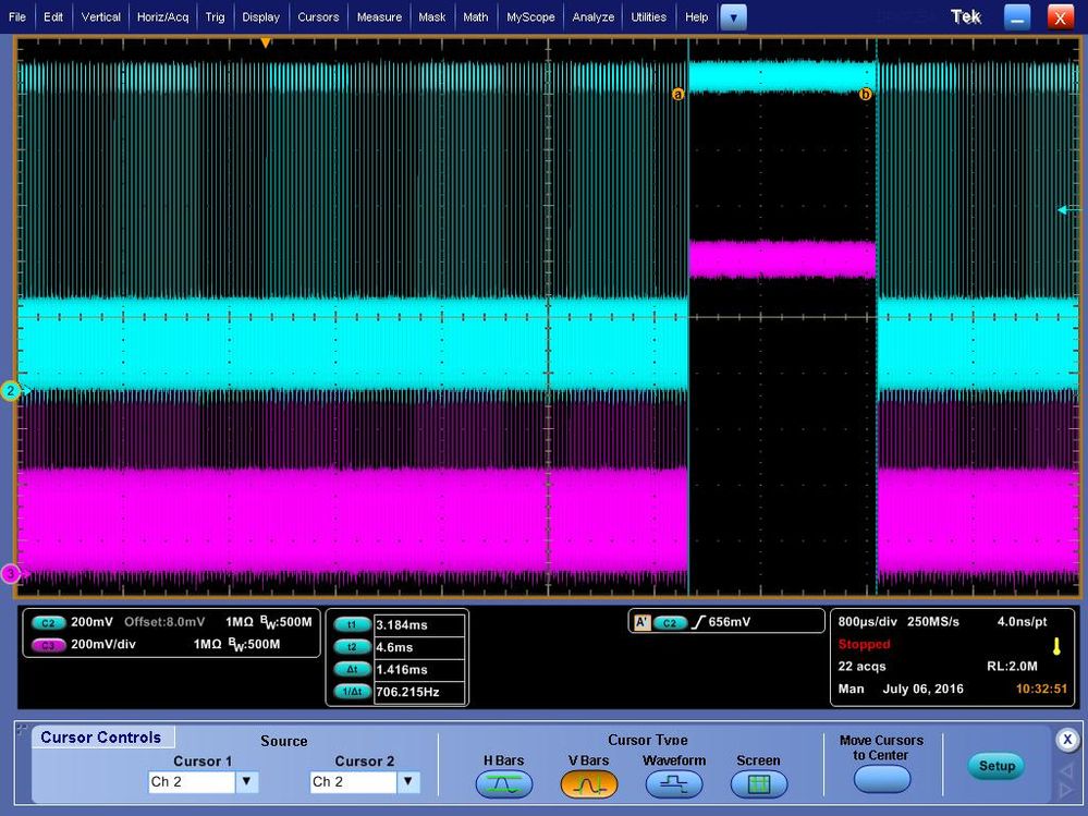

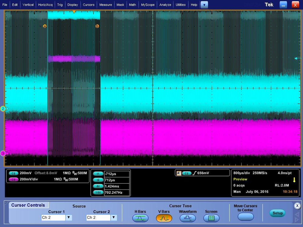

deshenggao
I upload the data line signal  of  ADV7480  and  TC358748.
the  data line signal of  ADV7480 (ch2 is  D+,   CH3 is D-)
this picture is  the Hsync end and start
in this picture , you will see the  vsync
below is the  data signal of  TC358748 (ch2 is  D+,   CH3 is D-)
You will see that there are some difference  between  them
About the Vsync  see that there are some difference  between  them
Does the i.MX6  should made different setting for these signal?
Please kindly check
Thank you!
