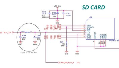

I am trying to configure GPIO_SD_B0_05 as PWM1 output, I do not need any interrupts, the pwm frequency should be 80Hz or 1kHz with a duty cycle of 80%.
The configuration that I have are shown below.
PIN config
IOMUXC_SetPinMux(IOMUXC_GPIO_SD_B0_05_FLEXPWM1_PWMB02, 0U);
MODE config
IOMUXC_SetPinConfig(IOMUXC_GPIO_SD_B0_05_FLEXPWM1_PWMB02, 0x10B0U);

I have debugged and verify the registers values, but still can't get to output the pwm signal from the pin.
Has anyone an idea or is there a configuration that I'm missing?

_Leo_
Hi @pamela_mz
Please check SDK example evkbimxrt1050_pwm, in Config Tools add pin J2 (GPIO_SD_B0_05) as shown below:
Run the example and on pin 2 of the SD Card (SD1_D3) of the MIMXRT1050-EVK you will see the PWM signal you need.
Hope it helps you.
Have a nice day!
