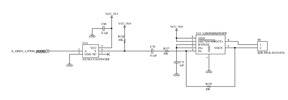

sankarsalla
Hi Alexander,
Pwm audio is working fine,but some noise came.
Thanks for your support.
Thanks & Regards,
Sankar.

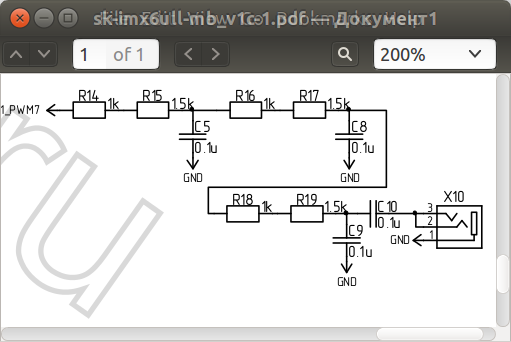

Sasamy
Hi Sankar.
We use the same driver and filter, but I would like to clarify - the nominal value of resistors r15, r17, r19 is 1.5 kOhm, it's hard to see in the screenshot.
Alexander

Sasamy
Hi Sankar.
We use a third-order RC filter with a 4kHz band without an amplifier.
Alexander

sankarsalla
Hi Alexander,
We implemented above circuit on general perpose board.
 while playing : aplay a2002011001-e02-8kHz.wav
nothing is coming out from speaker.
on oscilloscope monitor that on c5 one end puls signal is clipping(we are getting before R14 8KHz)
Thanks & Regards,
Sankar

sankarsalla
Hi Alexander,
Now aplay: pcm_write:2004: write error: Input/output error is solved.
But while playing .wav file some disturbance is coming (not able to listen).
We are using attached schematic for pwm audio.
It is correct or con you suggest any example schematic for pwm audio.
