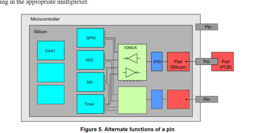

BiyongSUN
PAD is not related to GPIO.   GPIO is not PAD/PIN. PIN/PAD is not GPIO.
GPIO is module like UART, i2c, SPI, ADC.
no PAD mux configuration, GPIO still can work. just can not have output outside the chip.
4,395 Views
