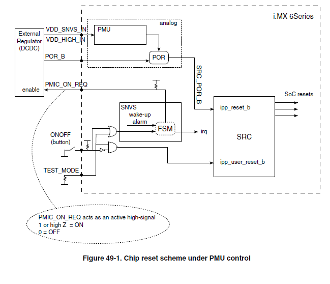

surendrajadhav
Dear Jose,
We have checked the supply rails by removing front end LDO, however we are observing the same issue of voltage dips after 5 sec.
So it seems its not related to this.
I am doubting on  SNVS_PMIC_ON_REQ (Bal T9 of CPU), as per datasheet it has to driven to Power on PMIC.
Currently we have not powered CPU and this unpowered ball is driving this pin.
The other way I think is, it needs external button input to Power on the PMIC.
There are three modes also inside the PMIC which gets enabled sequentially and during this period we may see voltage variations in the output.
Can this be one of the reason for voltage dips?

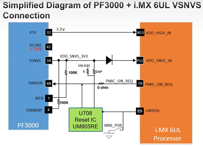

surendrajadhav
Dear Jose,
One more observation is that we are exactly pulses on PWRON pin with 5 sec delay between two consecutive pulses (Standby is pulled down by 10K and its low all the time, while PWRON pulled up but still we find pulses).
This time is exactly same the way we are getting voltage dips.
Do you suggest us to power VDD_SNVS_IN and VDD_HIGH_IN supply to CPU as below(i.MX6UL reference manual).
I think connecting VDD_SNVS_IN and VDD_HIGH_IN rails shall not affect or damage the CPU and CPU can take care of the PWRON and Standby pins.
Surendra

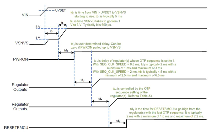

reyes
Hi Surendra,
Do you suggest us to power VDD_SNVS_IN and VDD_HIGH_IN supply to CPU as below (i.MX6UL reference manual).
[Answer] “while PWRON pulled up but still we find pulses” seems to be the reason. Is there any reset IC connected to PWRON? This reset IC would better be supplied by VIN 5.0V not directly by VSNVS pin of PF3000.
PF3000 PWRON pin should be always high to enable the whole chip and regulators, if PWRON is low, then the PF3000 (all regulators) is in Off mode by default, except any regulators whose SWxOMODE bit is set to “1” during On mode.
See the below connection, please try pull PF3000 PWRON pin always high to enable the whole PMIC, you can see all regulators power up only after PWRON pin is being pulled high. Capturing the PWRON pin waveform is needed for analysis.

surendrajadhav
Dear Jose Thanks a lot for your reply.
Today we did some work out on our board, which is as below:
  • Yesterday as expained we were geting 3.4V at Vin pin (Pin no.42) and LDOG pin 5V (Gate of ext MOSFET) while input was 5V. (You also asked to test this)
  • Yesterday we also observed that voltage on PWRNON (pin no. 48) was zero and STANDBY (pin no. 4) was also zero. With this we thought PMIC is in PWROFF or Standby mode.

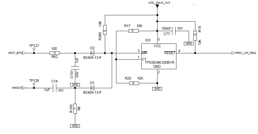

  • Today we connected VDD_SNVS_3V3 supply through 0 Ohm to circuit and PWRON and STANDBY pins got pull up to  VDD_SNVS_3V3, which might have brought PMIC out to PWR on mode.
  • After above change, we got voltage 4.25V at Vin pin (Pin no.42). This should be atleast 4.3V as per datasheet. However now we moved to test output voltages of PMIC. With this configuration we found all the voltage are coming out from PMIC as expected as per datasheet.
  • Now I have certain queries that, I have removed IC6 as shown below circuit, which was loading PMIC_ON_REQ (which is driving PWRON pin of CPU) and keeping the board in PWROFF mode. After removal of tthis chip I got 2.2V pull up on this pin.
  • Can I proceed with 4.25V, which is not as per datasheet.
  • As you mentioned yesterday that as per Table 6 Ivin should be less than 35uA, but how we can ensure its less than 35uA.
  • Can I drive VDD_SNVS_IN rail of CPU by VDD_SNVS_3V3 alone and remaining rails are not driven the CPU. Is it safe to do so?
  • I am not sure if I assemble IC6 it will load the PMIC_ON_REQ again and put the board in PWROFF mode.

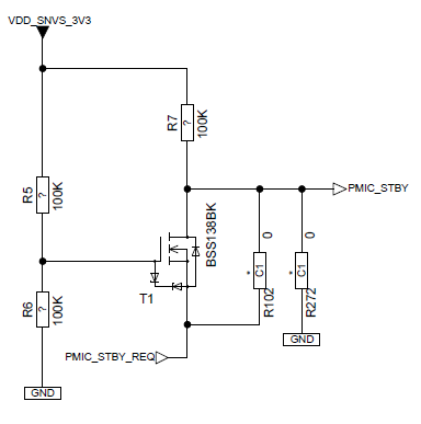

surendrajadhav
Dear Jose,
Thanks a lot for your reply. We had provision to Pull down the  Standby pin (#4 pin), which we did and started to get output.
However we have following circuit where we have used following MOSFET based as below.
As for current start, we removed R7 (Pull up and mounted R272) and PMIC is out of standby and we are getting outputs.
Now after assembling CPU and above circuit i.e. removing R272 and mounting R7, will PMIC again enters in Standby mode and no power shall be given to CPU.
