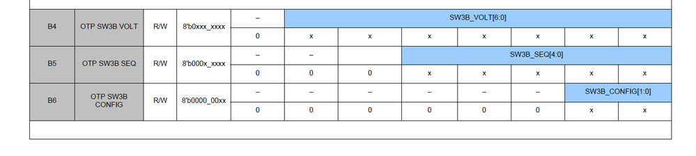

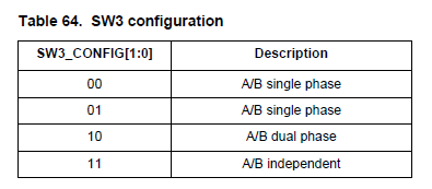

That design seems fine. Excuse me for that I have misunderstood you. However you are still omitting the fact that you did not program the PMIC. Since you bought a pre-programmed one, and all pre-programmed PMICs come with same settings regarding SW3 Mode, that is, SW3 is set to A/B Single Phase. However your configuration demands SW3A/B Independent settings.
I do not know if you can change the settings of SW3 for a pre-programmed PMIC so that SW3A/B is set to independent mode. I do not think its possible because SW3B_CONFIG[1:0] bits are OTP but its best someone from NXP answers that. We used a NP one for flexibility in our project.

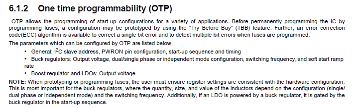

This is what I tried to explain earlier in the thread. The registers are fully programmable, the OTP part is purely for pre-loading registers at start-up, the register containing the SW3B_CONFIG bits remain R/W, as shown in the datasheet, all register status, whether Read Only or R/W is defined in the datasheet.

Thats actually good news to hear. I took it that since its named one time programmable, there is no means of changing the fuses once blown. It turns out its OTP only for the start up values as far as you have put it. Thanks for this information. Now it makes a lot more sense.

Yes I can understand why that could be confusing, the OTP refers to the start-up configuration, not the registers themselves, but if the registers are labelled OTP, that probably doesn't help.
I just found this in the datasheet, which again highlights the likely issue here -

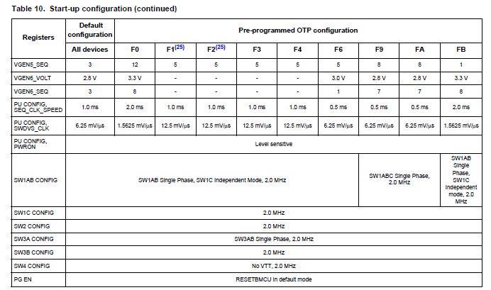

RossMcLuckie
You should review the PF0100 documentation, in particular the datasheet, can be found here -
14-Channel Configurable Power Management IC|NXP

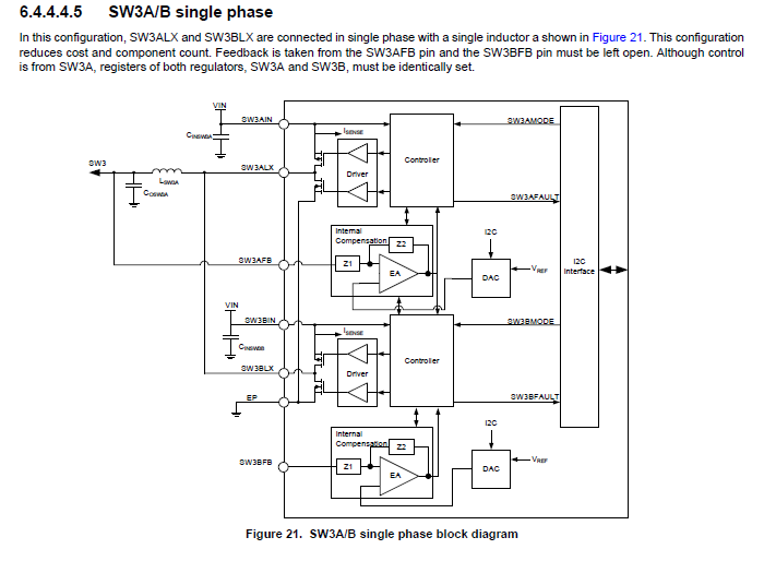

All variations of the PF0100 power up expecting SW3AB to be in single phase configuration, from datasheet -
Which would be configured in hardware as follows -

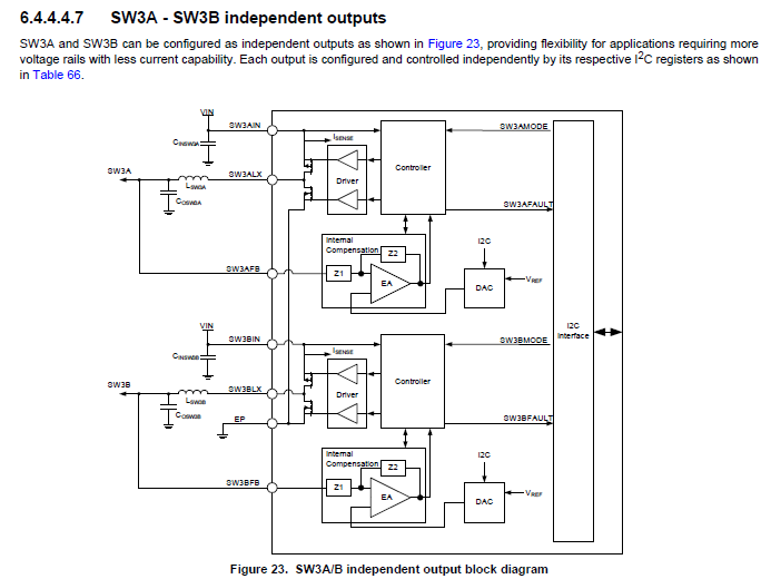

However you have your hardware configured for independent outputs -
So until you program the PF0100 registers to match your HW configuration the outputs will not be as you expect.
Ross

I am using pre-programme default configuration of MMPF0100. And default output voltage full fill my system required voltages to bring-up. My system is running well. But as per "Default Configuration voltage" I am unable to get SW3B = 1.5V. I have highlighted in below image. Instead of that I am getting SW3B = 2V. Kindly help me to solve this issue.

RossMcLuckie
I support iMX products, but have used the PF0100 in several designs, so although not an expert on its operation my understanding is as follows -
The default table shown above assumes SW3 to be in single phase mode, your hardware is configured for independent mode, for single phase SW3BFB should be left floating, your design has it connected to the SW3B output, so I'm assuming this is where the trouble lies.
All of this is from the PF0100 datasheet, rev 16, I would suggest you review this document again and make sure you understand all the set ups and settings.
Your design is configured as independent -
but the default register setting expects single phase -

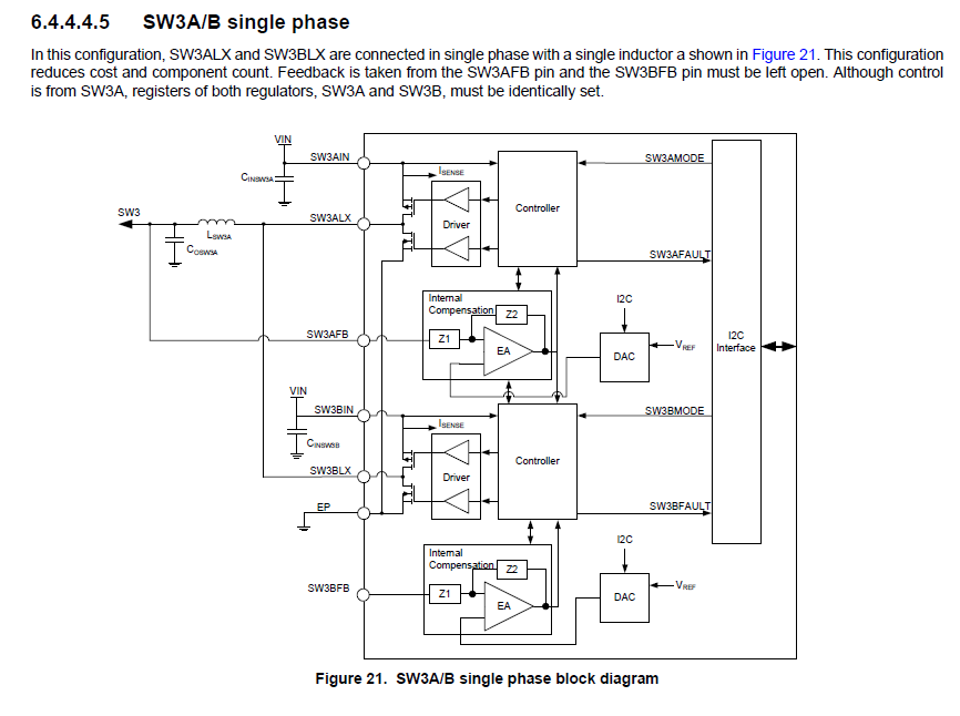

If you wanted to test this, looking at your schematic snippet attached I think you can convert from independent to single phase by -
  • Removing L6 (and most likely FB13, not sure if you have anything connected to the SW3B output)
  • Shorting SW3BLX (one of the L6 pads) to the SW3AFB net
  • Possibly you may need to remove C170, C171, C229 (requirement is to have SW3BFB open circuit, don't think the capacitors would be an issue, could try without removing first, if still an issue remove)
This should let you see 1.5V at SW3AB, with 2.5A capability.
To use your independent configured set up I believe you will have to reprogram one register value containing the SW3_CONFIG setting -
Can be found here -
Hope this helps.
