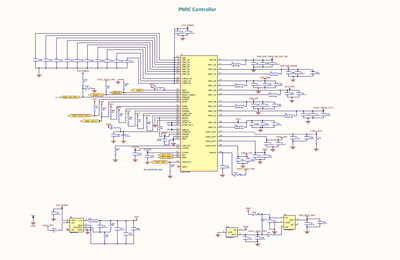

Wanted to know if there are any hardware ways to debug the issue further.  We are using PF8121 pmic in our board and the android version android - 11.

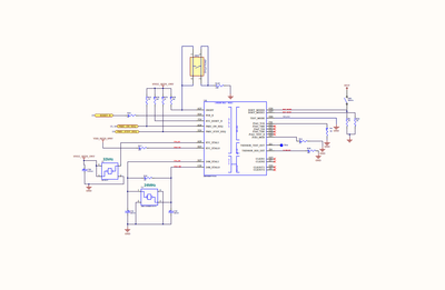

Please provide me with a schematic of PMIC and i.MX8MM SOC  & ONOFF button in a custom board.

Hi @Sanket_Parekh ,
Please find the attached schematics of pmic and imx8mm.

Hi @BHAVANI_S ,
I hope you are doing well.
Currently, I am reviewing the schematics sent by you.
