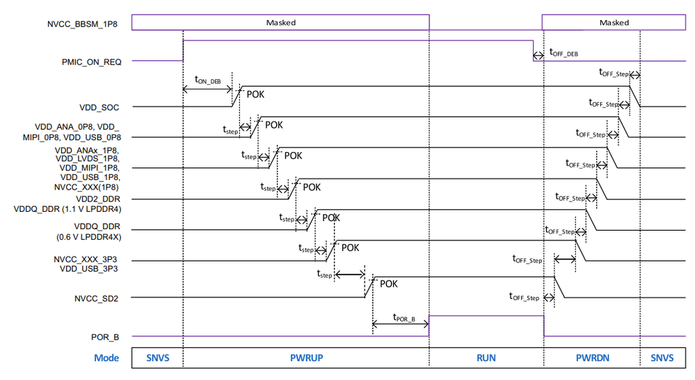

1. For i.MX power-up, you can go with the POR_B signal from the processor, the last stage is POR_B release (it should be asserted during the entire power-up sequence). For power-down, there are no exact signal and you could keep with POR_B signal, you should just add the steps and delay the cutoff the result of all the steps until VDD_SOC is released.
2. The second situation If PMIC_ON_REQ stays low, what is the logic that triggers PMIC_ON_REQ to go high when powering up? Is it tied to the transition of NVCC_BBSM_1P8 from unpowered to powered.
NVCC_BBSM_1P8 powering-up causes SRC to trigger PMIC_ON_REQ, during powerdown you will return to SNVS mode which allows you cut the power then.

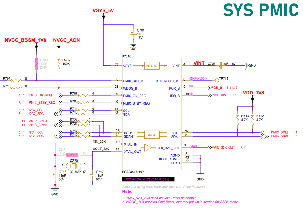

3. I reviewed them and the signal is connected, please see below,

  2. I would like to know the logic of PMIC_ON_REQ,
    this is the power down sequence we are referring to:
    1. A shutdown is triggered b software: NVCC_BBSM_1P8 remains high / PMIC_ON_REQ is triggered to low
      → PMIC enters the power-down process.
    2. The I.MX93 begins the power-down process.
    3. The I.MX93 shuts down while NVCC_BBSM_1P8 remains high, since the battery power is not cut down yet.
      What is the state of PMIC_ON_REQ at the moment?
      -> If PMIC_ON_REQ returns to high, does this mean it’s not possible to fully shut down the I.MX93?

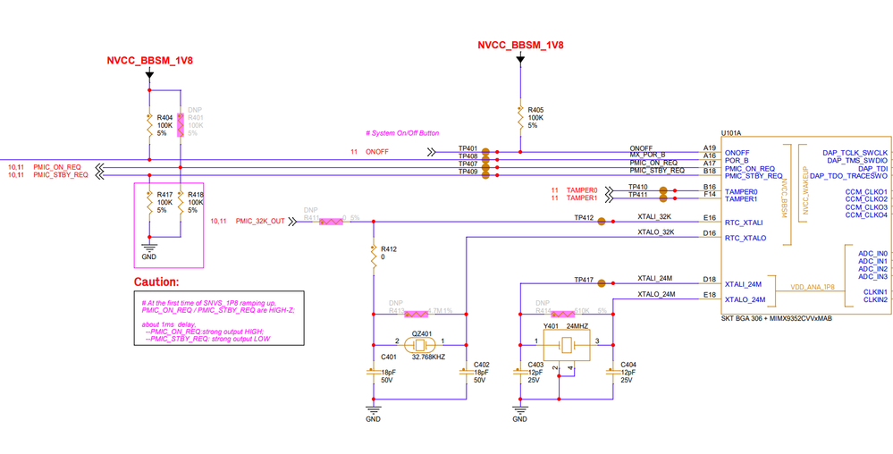

      -> If PMIC_ON_REQ stays low, what is the logic that triggers PMIC_ON_REQ to go high when powering up? Is it tied to the transition of NVCC_BBSM_1P8 from unpowered to powered
  3. We noticed in the EVK design that the I.MX93’s PMIC_ON_REQ is not connected to the PMIC. Could you help clarify the reasoning behind this design choice?

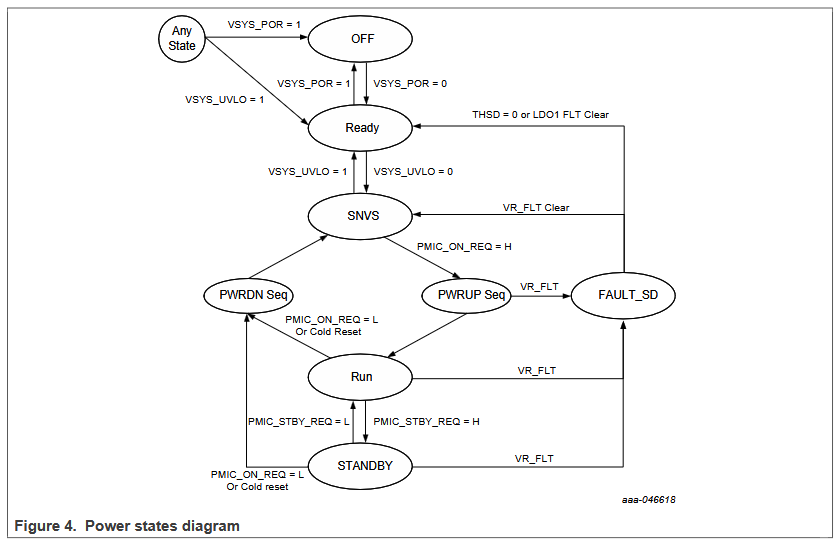

For question 1, you are right, for the PMIC side, you have to pass UVLO voltage so the PMIC is ready to initiate the power-up sequence. For the i.MX side, you have to power NVCC_BBSM_1P8 and the signal PMIC_ON_REQ will be triggered.
For question 2, yes, you could check this in EVK running the command, this sets the watchdog to expire and it's a cold reset source.
shutdown now
For question 3, using a battery-powered application is supported for the PMIC and the processor, nevertheless, no monitoring/management circuit is implemented, you would need to manage the battery with an additional circuitry.
For question 3.1, correct, PMIC_ON_REQ can control power-up and power-down multiple times, if you want the application not to power up constantly, you can go with the off-state of the PMIC option.
