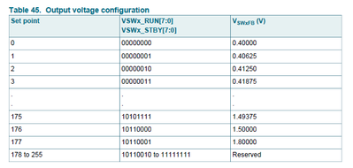

guoweisun
After PMIC start up,please use the IIC communication to set registers according below attached picture content.

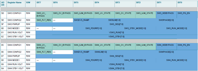

guoweisun
Above is the registers of SW3/4,
