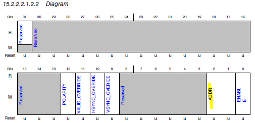

From IMX8DXAEC.pdf (Rev.0):
Regarding ADDR field in PLM_CTRL register.
We can select the destination module via this field.
Which module we can select at this field? Could you teach me selectable value and destinations?
Kazuma Sasaki.

  ADDR field is always set to default value, meaning that  we only support ISI output.

Hi Yuri,
I appreciate your support. I understood that we don't need set ADDR field. Is it right?

Correct.
