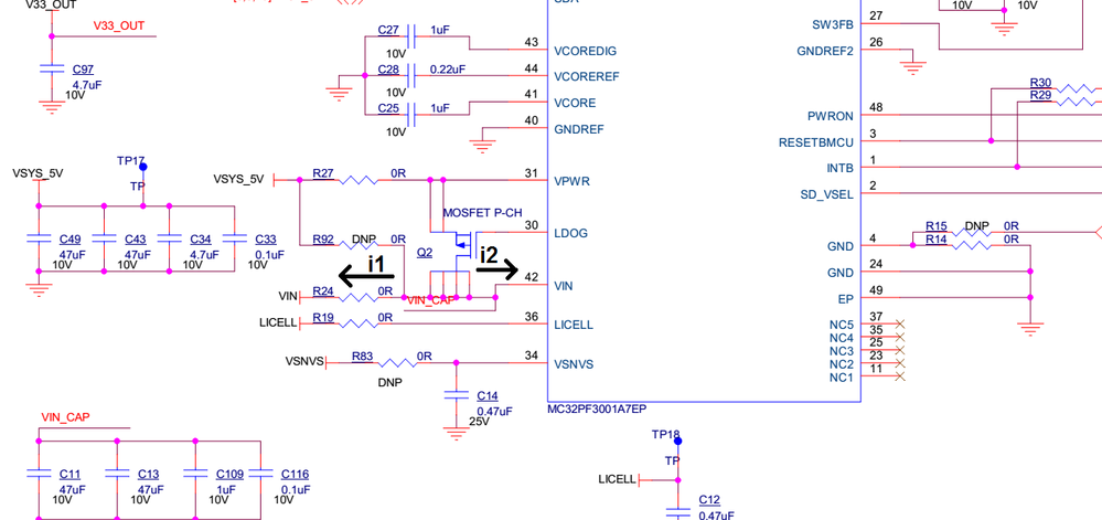

I am using PF3001 with iMX6UL in one of my design.
I am facing issue with PF3001. I am using 5V adapter to powerup the board. As recommended in PF3001, I have used external P-MOSFET.
Prior to this issue, PMIC power was ok and I was able to boot iMX6UL.
Now MOSFET is not turning ON. I have observed that Gate (LDOG) voltage and Source voltage (VPWR) are same, 5V.

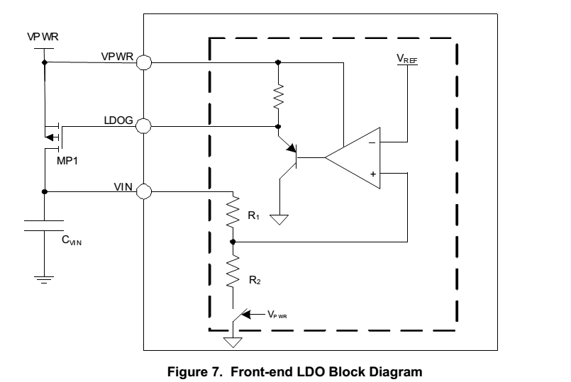

From below image (PF3001 datasheet Page # 31) it seems that it is only possible when internal PNP transistor is off.
Is there any damage internally in PF3001?

reyes
Hello Ritesh,
The problem seems to be that the PF3001 is detecting and under voltage condition on VIN, this device use an under voltage monitor at VIN which senses excessive droop on the VIN line and consequently turns off (disable) the external PMOS pass FET.
VIN voltage should be around 4.4V on operation mode when VPWR is 5.0V, I’m not sure what could be causing this voltage drop, can you please measure the current at VIN?

riteshpatel
Hi Jose,
Thanks for quick response.
Which current I need to check from below image?? i1 or i2??
i1 is current from Mosfet Drain to LDO & SW inputs.
i2 is current from Mosfet Drain to PMIC pin # 42 VIN.
Ritesh.

reyes
Hi Ritesh,
Measure the current i1 (from Mosfet Drain to LDO & SW inputs).
-Jose
3,977 Views
riteshpatel
i1 is varying between 0.4 to 0.6A.
