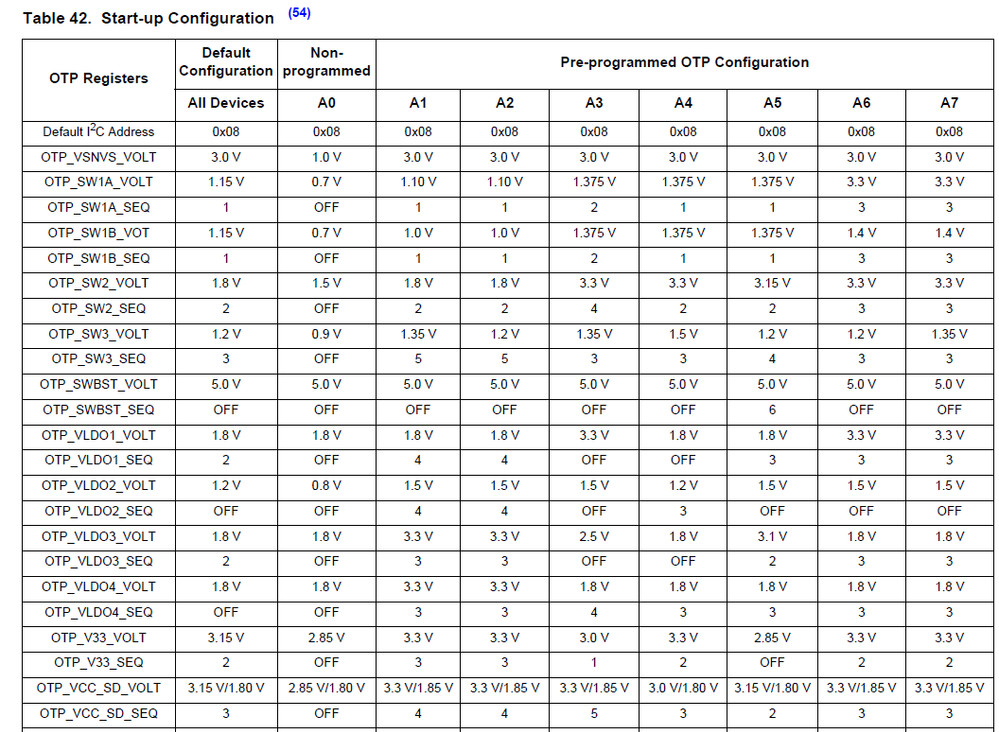

samcheck
Additional question regarding configuration of the PF3000
For i.MX6UL, only two configurations are valid: A6 and A7. A6 is made for LP-DDR2 whereas A7 is made for DDR3L.
In our design, we are using VLDO3 for supplying NAND flash with 3.3V. By default, the voltage on this supply is 1.8V.
  1. 1. Is it possible to order customized start-up configuration directly from the factory? Or do you see another way to change the default voltage of LDO3?
  2. 2. On the other side, with the setting of SW3, only DDR3L are supported and not standard DDR3. I assume that other customers have requested support for 1.5V DDR3 chip. How could we manage this?

reyes
Hi Samuel,
I would recommend you to contact the Marketing team if you need a custom programmed PF3000 from the factory.
I'm sending you an email with more details about your questions.
Jose
