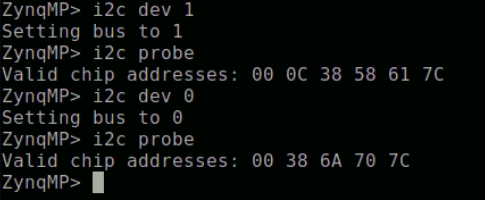

We have PCF8563TS RTC on our custom board which is not being detected in i2c interface, in both i2c probe in u-boot & also i2cdetect utility.
We are expecting 0xa2 address as mentioned in the data sheet.

Zhiming_Liu
Refering the device tree example, the address should be 0x51.

smsujan19
We are still unable to detect the RTC in i2c.
Any help would be appreciated.
133 Views
smsujan19
Hi Zhiming,
Well, even the address 0x51 is not detected in i2c probe scan.
We have a crystal SWS2129F48-32.768K which is connected b/w OSCI & OSCO.
Also there is a pull-up for i2c, which is working for other slaves.
Any ideas ?
