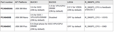

Thanks for your reply, we understood that PCA9450B is the focus of iMX8 Nano
but the question is: if we use PCA9450C for iMX8 Nano, is it possible? and any SW or HW config that we need to highlight
following the spec, it can be done by not using the BUCK3.
but imx8 and PCA9450C are communicated via i2c, so we need to check any SW configuration or not
714 Views
guoweisun
You need change dual phase configuration using two inductors instead of one, no need change for software side.
721 Views
guoweisun
The reference design is used the PCA9450B.
IMX8MNLPD4EVKHUG.pdf
The different between PCA9450B and PCA9450C are:
1:PCA9450B – Two 3 A buck regulators
   PCA9450C – 6 A dual-phase buck regulator and 3 A buck regulator
