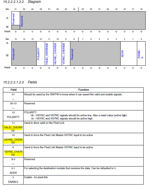

PLM_CTRL register has three kind of override fields.
What is the difference between VALID_OVERRIDE, HSYNC_OVERRIDE and VSYNC_OVERRIDE settings?
From IMX8DXAEC.pdf (Rev.0):

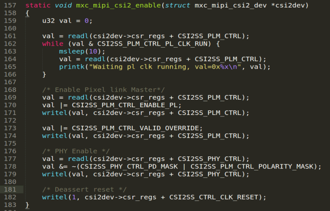

Copy from linux/drivers/media/platform/imx8/mxc-mipi-csi2.c
Kazuma Sasaki.

Hello Kazuma,
If valid_override is zero, this will override both HSYNC and VSYNC to be asserted.
If vsync_override is one, this will override VSYNC to be asserted.
If hsync_override is one, this will override HSYNC to be asserted.

Kazuma_Sasaki
Senior Contributor I
Dear Bio,
I got it. Thank you so much.
Kazuma Sasaki.
