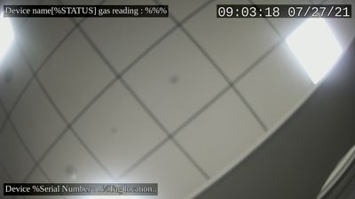

I am using gstreamer pipeline on i.MX8M Mini dual core platform (OS: Yocto L5.4.24-2.1.0) to capture a 5MP@20FPS camera input and put overlay on it using below command:
gst-launch-1.0 -v v4l2src device=/dev/video0 num-buffers=100 ! video/x-raw,width=2592,height=1944 ! queue ! imxvideoconvert_g2d ! video/x-raw,width=1920,height=1080 ! textoverlay text="Device name[%STATUS] reading : %%%" valignment=top halignment=left shaded-background=true ! textoverlay text="Device %Serial Number : ..%Tag location.." valignment=bottom halignment=left shaded-background=true ! clockoverlay halignment=right valignment=top shaded-background=true time-format="%H:%M:%S %D" ! vpuenc_h264 ! h264parse ! mp4mux ! filesink location=/home/root/video.mp4
Here is the expected output on the camera stream after applying the overlay.
When I use the above command, CPU utilisation increases to 120% (checked with top command) and the video is recorded at 6FPS. I have debugged that the Gstreamer overlay (which is a SW element) is causing the high CPU utilisation and subsequent FPS drop.

Thanks for the info. We ended-up using the imxcompositor in the end for our overlays, which uses nearly no CPU. Out of interest, what is the CPU usage with the Cairo library for your overlays?
2,911 Views
namanthaker
The CPU utilization was around 20% with Cairo Plugin.

We used Cairo Overlay pluging with Gstreamer to get the overlay elements. Our image was not build with FPU/NEON support.
Cairo Overlay : https://gstreamer.freedesktop.org/documentation/cairo/index.html?gi-language=c
