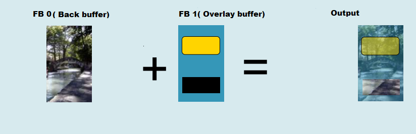

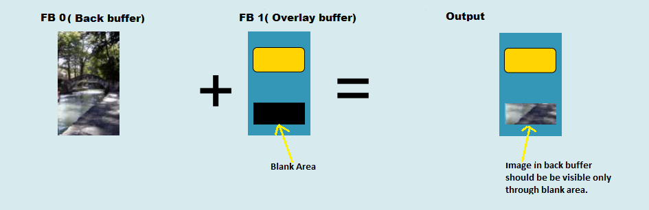

I am running two QT application in two frame buffers of freescale board(IMX-6).
App1 in /dev/fb0( primary buffer) and other( say App 2) in dev/fb1( overlay buffer) in Ubuntu  Linux.
I can see both application together. But, my expectation is to see only
App2 running on overlay buffer. App1 running in back buffer( /de/fb0) should be visible only when App2 area is blank.
I am a beginner i.MX frame buffer area. Any command/ environment is available to set the opacity( or transparency?) of front buffer? Or I need to use alpha blending technique in my program?. I don't want to change transparency dynamically.

MXCFB_SET_GBL_ALPHA is a global alpha (opacity) for the overlay framebuffer.
  • MXCFB_SET_GBL_ALPHA = 0
    The overlay framebuffer is fully transparent - therefore invisible.
  • MXCFB_SET_GBL_ALPHA = 255
    The overlay framebuffer is fully opaque, and therefore the underlay is completely hidden.
In the above you've set it to 0, therefore the overlay is invisible. You'll want 255 to get the effect shown in your earlier drawings.
Color Keying can be used to "cut holes" in the overlay, to display some part of the underlay.
It works by looking at the colour of the overlay framebuffer pixel. If the pixel is the same colour as the "color_key" then the underlay is drawn. If it is not, the overlay is drawn.
To create your "cutout", you draw the cutout using the keying colour.
This means that the keying chosen must never be present in your normal overlay framebuffer images - so black is probably a bad choice.

If you cannot achieve the desired functionality using gloabl alpha blending and color keying, try local alpha blending mode with alpha values in pixels option. You can refer to i.MX6: Alpha blending example code  where I posted example code to test local alpha blending. For your use-case, you can set the alpha values of the region where it is expected to show image from the background buffer to 0 in the overlay buffer. You can achieve that by using transparency/opacity settings of Qt widgets in application-2.

Richard2

arunmenon
Hi Richard,
Sorry for the late reply. I was on vacation.
Thanks for your detailed explanation. It did the trick. Now, I can see some part of underlay.
Ya... Now, i am checking for a good choice of color.
I shall ping if I have further problem
Arun
4,344 Views
arunmenon
Hi Saurabh,
I am little bit confused, whether i need to enable alpha blending or disable alpha blending.
Actual output and my expectation is attached. Can you please check.
     Actual output:
     Expected output:
Thanks for your patience.
Arun

saurabh206
Senior Contributor III
Hi Arun,
You can use "color keying" for your requirement.
Saurabh
