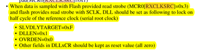

Thanks for the quick reply. I am a bit confused about that MCRO[RXCLKSRC].
Because when I tried to change RXCLKSRC to 0x3 in flexSPI driver I observed kernel panic. Then after looking into the reference manual I found this statement
Thah is why I am asking if there is any document or procedure which I can follow to achieve proper clock?

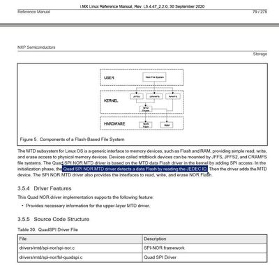

I am afraid you can not manually change frequency, as for example in
case for spi-nor usage, it is selected automatically by spi-nor driver
reading memory capabilities as described in JESD216 SFDP  specification
https://source.codeaurora.org/external/imx/linux-imx/tree/drivers/mtd/spi-nor/spi-nor.c?h=imx_5.4.47...
igor

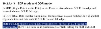

As per the reference manual
We are observing that in SDR mode we are getting the same clock frequency as serial clock and half clock frequency in DDR mode.
Is this the expected behavior?
probably linux driver selects mode which is supported by that particular
spi-nor, one can try to debug fspi driver using AN 12631
Normal and Secure Debug for i.MX8/8X Family of Applications Processors

I think there is some misunderstanding. I will again ask my query
As per reference manual IMX8DQXPRM Rev. E Table 18-4, it is mentioned that half clock frequency in DDR mode and the same frequency as the serial clock in SDR mode. We are also observing the same behavior.
Thank you
