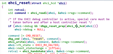

dear expert :
   on imx8qxp platform ,we configure usbotg1 to OTG mode,we found that if we  switch usb role from gadget to host , the os will be abnormal ;
in most cases , it will show follow log repeatedly:
[ 1140.418947] Task dump for CPU 2:
[ 1140.422180] swapper/2       R  running task        0     0      1 0x0000002a
[ 1140.429233] Call trace:
[ 1140.431695]  __switch_to+0xf8/0x160
[ 1140.435192]  __cpu_online_mask+0x0/0x20
[ 1203.403893] rcu: INFO: rcu_preempt detected stalls on CPUs/tasks:
[ 1203.410014] rcu:    2-...0: (1 GPs behind) idle=6aa/0/0x1 softirq=172961/172962 fqs=20045
[ 1203.418110]     (detected by 3, t=84016 jiffies, g=499141, q=41071)
[ 1203.424120] Task dump for CPU 2:
[ 1203.427353] swapper/2       R  running task        0     0      1 0x0000002a
and the OS may be hung up and serial port can not input;
in other cases , different driver communication error will be printed :
root@imx8qxpc0mek:~# [   63.230102] imx-scu scu: RPC send msg timeout
[   63.234503] sdhc0_clk: clk unprepare failed -110
[   65.278105] fsl_lpspi 5a020000.spi: I/O Error in DMA TX
[   65.284636] spidev spi2.0: SPI transfer failed: -110
[   65.289759] spi_master spi2: failed to transfer one message from queue
and  the error : rcu_preempt detected stalls on CPUs/tasks  still be printed

mashaofeng
i trace the problem, it seems after cmd_reset send, the error will be occurred;
