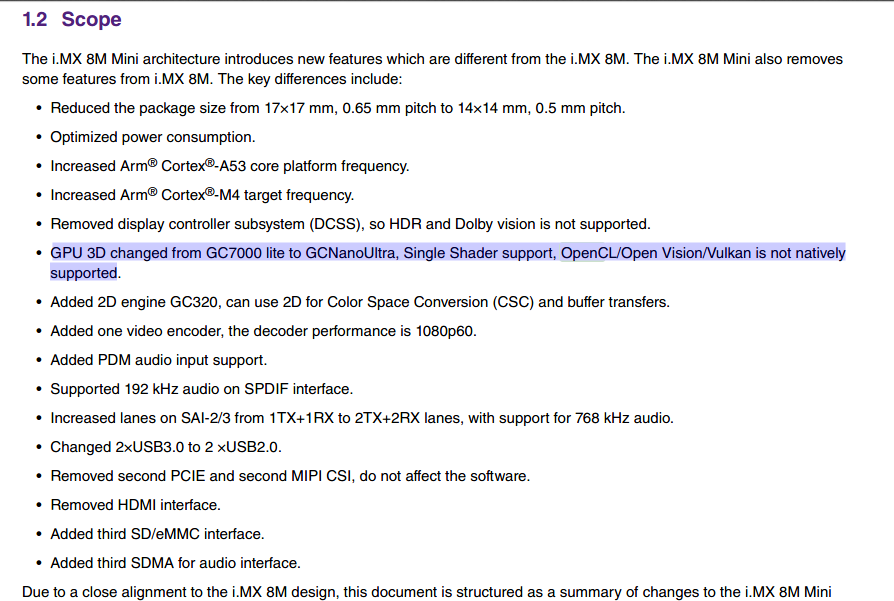

As per NXP, OpenCV library doesnt support on IMX8MMini
ref the below link
https://www.nxp.com/docs/en/application-note/AN12296.pdf

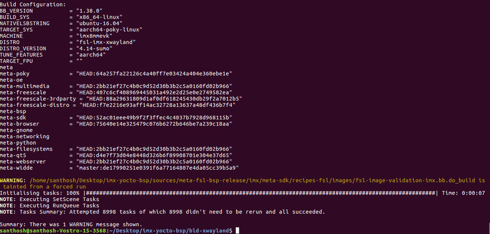

santhosh2
No errors for Yocto compilation Without  line below line in local.conf file
CORE_IMAGE_EXTRA_INSTALL += "libgtk2-0-dev "

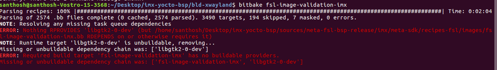

santhosh2
I have tried already adding to CORE_IMAGE and compiling, I am getting below error message.
Yocto Compilation Error
It Says no un build-able dependency
Let me know any other issue it might have
