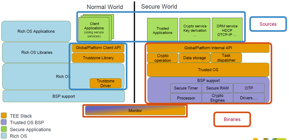

eric_kang
Dear Eugene,
Thanks for your response.
It's helpful to me, I'll try to the OP-TEE patch into our code.
I have additional question.
I know TEE has the following functions.
- 2 OS on i.MX6Q, Rich OS & Trusted OS
- Data is passed through Monitor between the 2 OSes.
Could you give me some example for data communication between 2 OSes?
Eric.
5,469 Views
eugenetodoruk
Dear Eric,
Data is passed between OSes through shared memory. Communication is provided by Linux Kernel driver by means of SMC call.
You may find examples here: GitHub - linaro-swg/optee_examples: OP-TEE Sample Applications
Eugene
