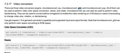

Try to resize video size using imxvideoconvert_g2d plugin
