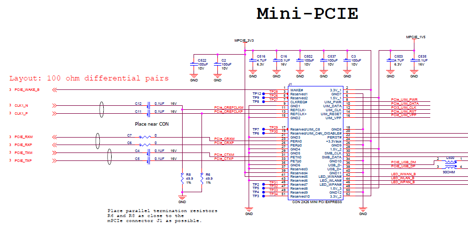

In our use case, system power sometimes down in spite of pcie device power always on.
It means few current supply from PCIE_RXM/PCIE_RXP pins to the i.MX6.
Does this connection cause any damages to the i.MX6?
Can anyone help me?

yes providing externally voltages to unpowered i.MX may affect its reliability
and sect.4.2.1 Power-Up Sequence i.MX6DQ Datasheet notes:
NOTE
Ensure that there is no back voltage (leakage) from any supply on the board
towards the 3.3 V supply (for example, from the external components that
use both the 1.8 V and 3.3 V supplies).
http://www.nxp.com/docs/en/data-sheet/IMX6DQCEC.pdf
from sect.4.2 Power Supplies Requirements and Restrictions :
Any deviation from these..may result..
* Irreversible damage to the processor
igor

Dear Igor,igorpadykov
I reviewed the difference between MCIMX6DL-SDP and our board then some questions came up.
According to the PCIe standard, All Transmitters shall be AC coupled such as PCIE_RXM/PCIE_RXP.
  PCIe AC coupling capacitors values
  https://community.nxp.com/thread/463277
  See p357
  http://composter.com.ua/documents/PCI_Express_Base_Specification_Revision_3.0.pdf
(Q1) Why 0 ohm resister placed at C7 and C8 instead of capacitor?
        Please see circuit diagram SPF-27417_C4.pdf on page 16.
In our board, 0.1uF cap placed on PCIE_RXM/PCIE_RXP lines, so that DC current will never leak.
(Q2) In such case Can I forget about fatal damage to the i.MX6 as I asked before?
I think coupling capacitors may be eliminated for REFCLKM/P but there was differential termination and AC coupled
in the MCIMX6DL-SDP schematics.
(Q3) Why reference clocks also AC coupled?
Thanks.
yes
>(Q1)Why..(Q3) Why reference clocks also AC coupled?
please create new thread for that new questions.
