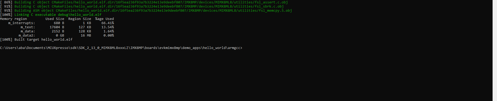

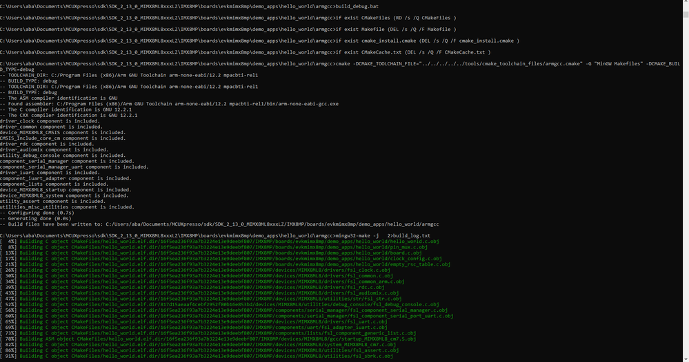

ababatola
hi,
Thanks for your response.
As said in my message, I did the build based on section 5.2 (of the getting started with MCUXpresso SDK for EVK-MIMX8MP) which is a build on a windows OS host.
Snapshots of the build process are below
However if I have to do the build on a linux host, I can also do that.
Thanks.
