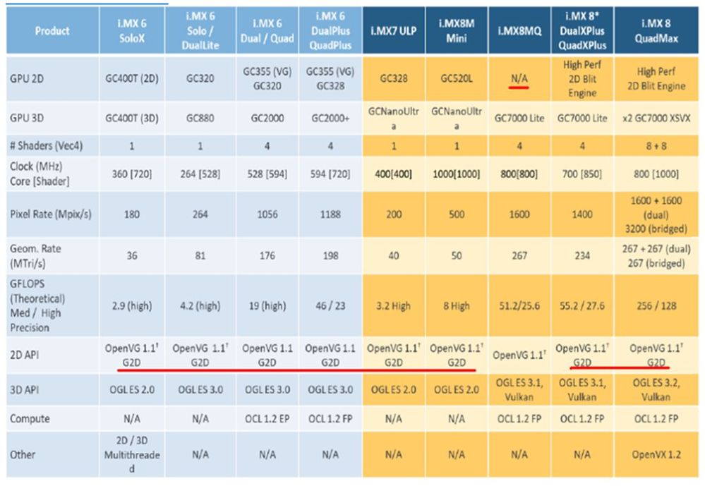

In an NXP document it states that imx8mq has no 2D (thus no G2D) video acceleration.
I want to use  imxvideoconvert_g2d element in gstreamer but this seems not to exist for  imx8mq.

Hello Malik,
    Yes, GPU in i.MX8MQ only supports 3D, not supports 2D acceleration.
